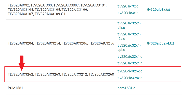

  • Hello Vishal,
    You  can find  all the available Linux drivers for different devices in this page.
     https://e2e.ti.com/support/audio-group/audio/f/audio-forum/773056/faq-linux-drivers-device-drivers-for-aic31xx-dac31xx-aic325x-aic320x-aic326x-aic321x
    Arash
  • Hi  ,
    I downloaded the tlv320aic326x.c and tlv320aic326x.h from the link you mentioned.
    I also downloaded the dependent .c / .h files as below (from the same source tree link).
    include/linux/mfd/tlv320aic3262-registers.h
    include/linux/mfd/tlv320aic3xxx-core.h
    sound/soc/codecs/aic3xxx/

  • Hello Vishal, I asked one of our software experts, Raphael,  to take a look at this as I am not the right person to help furthur.
    Arash
