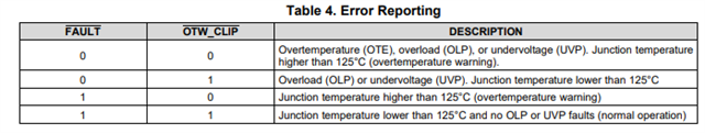

    This device was designed to drive signals within the PVDD to ground rails. With that, the device has both overload and DC speaker protection features. I believe the main issue is that you are driving a very clipped signal which is causing the amplifier to fault. I believe increasing PVDD to a level such that the signal is within PVDD and ground (no clipping) will resolve the issue. Can you test this? You could try with max PVDD.
    Also for future use you can use the below table to understand which specific faults are triggering.

  • I can test that. I am just a bit puzzled as to why I don't really get to much lower of a load impedance capability in PBTL mode compared to BTL stereo mode or why the clipping should cause the overcurrent protection to trip. I suppose that amount of clipping is a bit unusual, or if device temperature was used internally to adjust the overcurrent threshold, these observations would make a lot of sense. Most the drive-by-wire H-bridge ICs I use (I design automotive ECUs most of the time) have that temperature-dependent graceful degradation function built in. I did check and I am getting OLP status above (/FAULT is low, /OTW_CLIP is high - though it pulses low during clipping), probably not UVP since I've probed for voltage drops on PVDD already.
