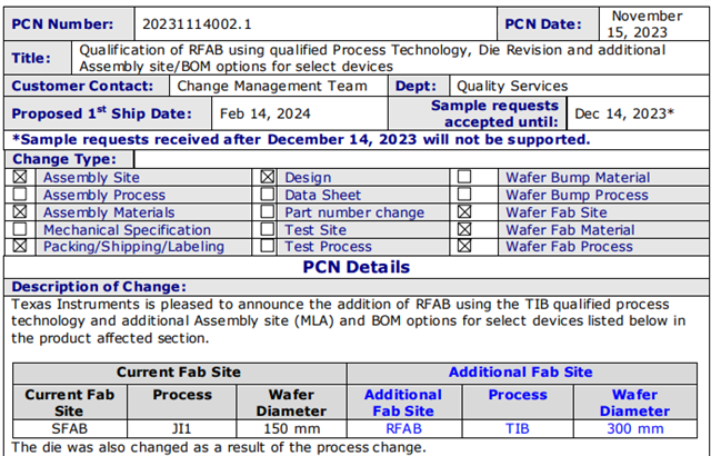

    The PCN has issued in NE5532 product due to RFAB change. Both pre-PCN and post-PCN are in the inventory currently.
    The "good" ICs, made in Mexico is likely manufactured by pre-PCN process. The "bad" ICs (made in Malaysia) by the customer is likely the post-PCN good that is related to the information below.
    https://mm.digikey.com/Volume0/opasdata/d220001/medias/docus/5726/PCN20231114002.1.pdf
    Both pre-PCN and post-PCN products are equivalent, but they may have some differences (e.g. GBW and open loop output impedance etc.). If the customer is able to send us the schematic, we can review the circuit and make a suggestion to compensate for the post-PCN op amp product. It is likely that it is op amp stability related issues in post-PCN product. Please specify the findings that are associated with "bad" behaviors, so that we can correct the behaviors for the customer's product.

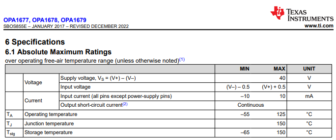

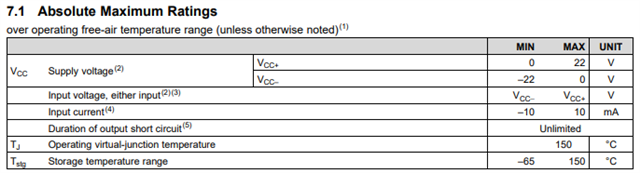

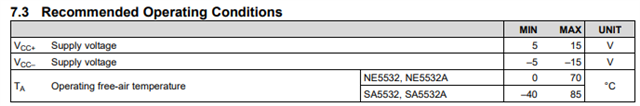

    I understand your frustration. However, the pre-PCN NE5532DR's max. supply ratings is up to ±22Vdc, and the recommended operating voltage is only rated up to ±15Vdc or total Vs = Vcc - Vee <= 30Vdc (single supply rail).
    The post-PCN NE5532DR is rated at the similar range, slightly higher in the recommended operating voltage up to +/-16Vdc, NOT +/-20Vdc. In addition, the abs. max. voltage rating in the post-PCN is rated slightly lower up to 36Vdc (36Vdc in single supply rail, or +/-18Vdc in dual supplies), which is the abs. max. ratings.
    If your product has to withstand +/-20Vdc in abs. max. ratings, then please consider OPA1678 or similar audio amplifier product. OPA1678 is a low cost and high performance audio amplifier. In terms of recommended operating voltage, it is still considered as 36Vdc in a single supply or +/-18V in dual supplies.
