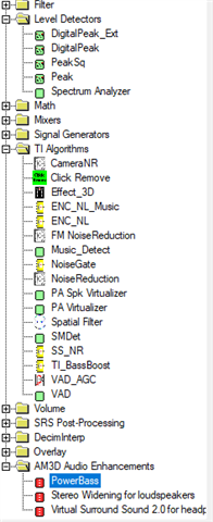

I am working with the TLV320AIC3254 codec in my project. I have two analog microphones and two digital microphones connected to the codec. I want to be able to use either the analog or digital microphones for signal processing.
My requirement is to perform different noise cancellation techniques, such as:
  1. Active Noise Cancellation (ANC)
  2. Acoustic Echo Cancellation (AEC)
  3. Beamforming
  4. Adaptive Filters

    5. could you please suggest which noise cancellation techniques are practically possible to implement on the TLV320AIC3254 codec itself?
    I will go through your questions one by one.
    A: The processing blocks are the built-in processing systems available on the device WITHOUT using miniDSP. If you want to use miniDSP, the processing block no longer is used, and vice versa. The main thing the processing blocks are used for is changing the signal chain of how many filters are used as well as if the AGC is able to be enabled. There are some user-programmable biquad filters as well as FIR and IIR filters. You would use a processing block when you are not using miniDSP, and in fact will always be one enabled if miniDSP is not used. MiniDSP is what you would use PurePath Studio to configure. There are of course filters and AGC, but also complex routing is able to be done, and specific algorithms can be run. There are too many options to list, I would recommend you download PurePath Studio (PPS) and see if there are options that you would like to use. Here are some screenshots of the options for the miniDSP algos:
    B: Processing blocks would be if you are not using miniDSP. If you just want some filters, don't use miniDSP. If you want any of the routing or algorithms to use, you can use miniDSP.
    C: Noise cancellation would require another DSP. The miniDSP on the AIC3254 does have a "noise reduction" algorithm, but this will be a rudimentary one made out of filters. Noise cancellation involves playing back an inverted signal and processing, I believe this is too much too fast for the DSP to handle in this device. Most of the interesting algorithms that exist for this device only work at 16kHz sample rate or below, so this also would be too low for an appropriate response in a real AEC/ANC system. There used to be an AEC algorithm in PPS for this device but it has since been removed, I believe it did not work well.
    D: Adaptive filtering is able to be enabled in both miniDSP and processing blocks, I believe. In this device, adaptive filtering is when the filter coefficients can be changed while the device is on and already passing data through. There is a double buffer for the filter coefficients, so when one filter is being used, you can change the coefficients in the other buffer and then switch it over. The idea in a noise cancellation system would be to adapt the filters to cancel out background noise, and adjust it based on a microphone input. However, again this is just filters, and there is some latency for the coefficient buffers switching - and this is not technically noise cancellation, just a noise reduction via filtering. Often background noise is also in the voice band or audio band that you would want to hear, so filtering would also harm the quality of the sound intended. Real noise cancellation inverts the noise so that the signal that is desired can be unaffected.
    E: Mainly filtering-oriented algorithms are most optimal to run on the codec itself, and gain level adjustments. Any of the effects I showed in the screenshots are reasonable to use. I also think miniDSP is useful to route signals through various inputs and outputs through mixers and splitters and such.

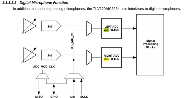

    i have another query regarding  Digital Mic Connection and Record/Playback Paths in TLV320AIC3254.
    1.Digital Mic and ADC Connection
          In the reference guide, it shows that digital microphones are attached to the ADC. Since I am using an I²S digital microphone, which already outputs         a digital bitstream, I am confused about the purpose of this connection.
          If the mic already provides digital data, what additional role does the ADC stage have in this case.
    2.Record and Playback Paths
    I would like clarification on the execution of the record and playback paths inside the TLV320AIC3254.
               In which part of the record path are the digital microphones connected
               In which part of the playback path is the digital mic data routed?
    Typically when we are talking about digital microphones we are talking about PCM digital microphones, not I2S mics. PCM microphones output data that is about the same as the ADC encoded data internal to the device, NOT I2S - it uses the modulator clock as its clock for the digital data. If your microphone outputs I2S, it does not need to go through the ADC at all, instead you would use it as the input to the DAC.
    Mir

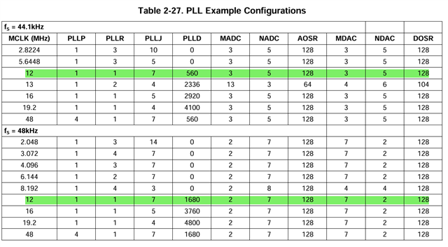

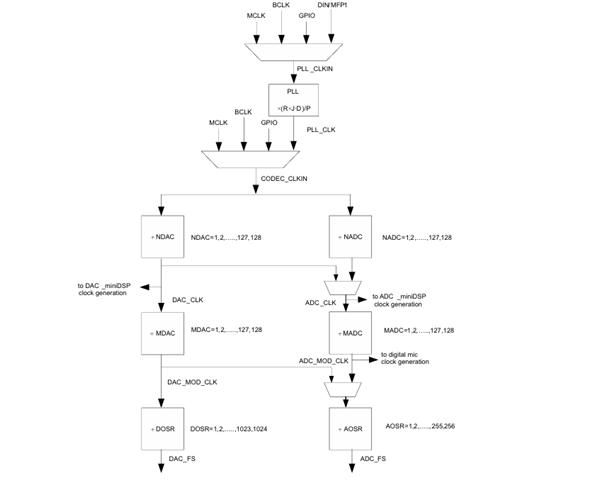

    I have a query regarding the clock generation in the TLV320AIC3254 codec.
    I am using the PLL to generate my desired sampling rate, I am not able to be generating the sampling rate(WCLK) and Bit clock.  I have followed the process shown in the attached clock-tree diagram
    Her my MCLK is 12MHZ, and MCLK is the input to PLL_CLKIN.
    i am taking the ADC_MOD_CLK input to BDIV_CLKIN
    i want to generate the sampling rate of 48khz
    i have configured all register values regarding PLL from reference guide.
    Register - 4      value -0x43
    Register - 5      value -0x91
    Register - 6      value -0x07
    Register - 7      value -0x06
    Register - 8      value -0x90
    Register - 11      value -0x82
    Register - 12     value -0x87
    Register - 13      value -0x00
    Register - 14     value -0x80
    Register - 18      value -0x87
    Register - 19     value -0x82
    Register - 20      value -0x80
    Register - 27      value -0x3c
    Register - 28      value -0x00
    Register - 29     value -0x03
    Register - 30      value -0x88

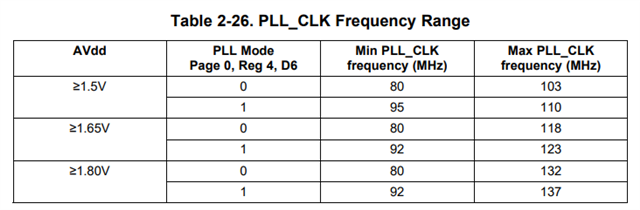

    There are a few things you should change here to get the right clocks out. First, register 4 should be set to 0x03, this "high PLL range" is seen in this table from the reference guide:
    With these PLL settings of J.D = 7.1680 or 7.560, the PLL_CLK will be too low for the "high PLL clock range" starting at 92MHz.
    Next, I would recommend that NDAC=NADC and MDAC=MADC, I see in this example it sets NADC=7 and NDAC=2, and then vice versa for MADC/MDAC. It may be better if you set these to be the same, just in case for future reference if you are using a different clock as an output and get confused why the DAC internal clocks are different than the ADC clocks. It will not affect your specific problem right now since you are using ADC_MOD_CLK as the BCLK divider input, which is after both N and M dividers.
    Finally, if I do the calculation to get what your ADC_MOD_CLK will be -> 12MHz * 7.1680/(7*2) = 6.144MHz. You used BCLK NDIV of 8, so that would be this divided by 8, but since you selected I2S 32 bit, we expect the BCLK to be 48kHz * 32 * 2 = 3.072MHz. So, your BCLK NDIV should be 2 instead (register 30 to 0x82).
    Let me know if this fixes the problem or if you are still having issues.

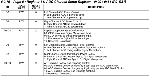

  • Hi Mir ,
    I am working with the TLV320AIC3254 codec. I have connected two I2S digital microphones (one left, one right) to the primary I2S interface of the codec. My goal is to route the microphone audio directly to the headphones (playback path) using the miniDSP.
    Currently, I am testing with only the right channel digital mic connected. I have powered up the right ADC and routed the signal through the right DAC (HPR output).
    My clocks are generated correctly:
    • WCLK = 48 kHz
    • Bit width  = 32 bit
    • BCLK = 3.072 MHz
    I followed the reference document provided earlier and configured the registers accordingly, including some additional registers. However, instead of clear audio, I only get continuous noise at the headphone output.
    From previous forum discussions, I understand that the digital I2S mics should be routed through miniDSP D and then to the DACs for headphone output. Could you please help me understand why I might still be getting only noise?
    I will attach my clock and right ADC configuration code for reference

    I2S digital mic right channel configurations
    codec_write(0, 0x00); // selecting page 0
    codec_write(60, 0x08);
    codec_write(0, 0x01); // selecting page 1
    codec_write(20, 0x25);
    codec_write(10, 0x03);
    codec_write(13, 0x08);
    codec_write(4, 0x00);
    codec_write(81, 0x20);
    codec_write(53, 0x03);
    codec_write(54, 0x02);
    codec_write(31, 0x00);
    codec_write(32, 0x00);
    codec_write(33, 0x11);
    codec_write(17, 0x0F);
    codec_write(9, 0x10);
    k_msleep(2500);
    codec_write(63, 0x44);
    codec_write(64, 0x08);
    codec_write(66, 0x00);
  • In my implementation I am using Processing Block 8 rather than the  configuring the minidsp path  ( refer the register i have attached)  described in the application reference (starting p. 89 of SLA A408A) to route the digital mic data to the DAC.
     https://www.ti.com/lit/an/slaa408a/slaa408a.pdf
    Can you share what the output of your microphone looks like on a scope next to the clocks? And a schematic of your system? Your code seems good at first read through.

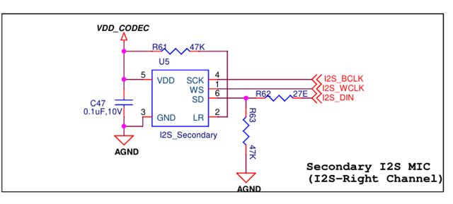

    • I am working with the TLV320AIC3254 codec and a digital microphone connected to its DIN pin. Below is my hardware configuration:
      • In the schematic, R47 is not mounted and R49 is mounted.
      • The DIN pin of the digital mic is connected both to the TLV320AIC3254 and to the MCU.
      • When I capture mic data directly from the MCU through i2s, I can confirm that the digital microphones are working fine (data looks valid).
      • However, when I route the mic audio to the codec and play it through headphones, I continuously hear noise instead of clean audio.
    • Digital mic → MCU path works fine (data is captured correctly).
    • Digital mic → TLV320AIC3254 → Headphones path gives only noise.
      i am attaching Schematic of the digital mic (secondary channel) and codec connections.

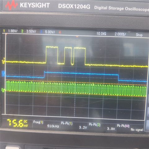

  • The first scope capture shows the I²S data from the right-channel digital microphone connected to the codec, along with the corresponding clocks
    The second scope capture shows the I²S data from both the left and right channel microphones connected to the TLV320AIC3254 codec, along with the clocks.
    green --- BLCK
    blue ---- WCLK
    yellow ---- left and right audio data
    If you could share your headphone output part of the schematic that may be helpful as well as the power supply connections.

  • Here is the schematic of the codec. I have tried the register settings suggested in the forum, but I still do not get audio output from the digital microphone.
    • The VDD_SYS supply is at 2.7 V.
    • I also tested the Mixer Amplifier path:
      • IN2L, IN2R → Left MIC PGA → Left Mixer Amplifier → Headphones (HPL + HPR)
      • In this path, I am able to get clean audio from the headphones.
    • This confirms that my headphone path and register configuration for the headphone output are working correctly.
    • When I capture mic data directly from the MCU through i2s, I can confirm that the digital microphones are working fine ,in the pervious forum i have pasted the data
    • I have attached the scope captures of the digital mic I²S signals (both left and right channels). These waveforms confirm that the digital microphones are working fine.
    • I suspect that the issue is specifically in the signal path from the digital mic to the DAC
