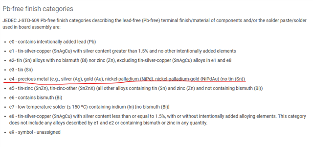

What is different between 6PADC3140IRTWRG4 and TLV320ADC3140?

The 6PADC3140IRTWRG4 is an E4 equivalent of the TLV320ADC3140, per the JEDEC standard. The below link describes the standard and the product naming in more detail.
Logo product labeling | Environmental information (Eco-info) | Quality & reliability | TI.com

Unless the end-system specifically requires devices with a precious metal finish (NiPdAu), you can use the TLV320ADC3140 in your application.
