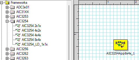

  • Hi Martin,
    Can you share screenshots of your issue? I have been using PPS on Windows 10 and 11 with no problems. The component library is a drag and drop interface, so if you see the "AIC3254 8x4x" under AIC3254 in the Frameworks section, you can drag and drop it to the main diagram.

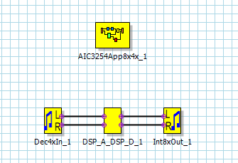

    Once you have the Framework in your diagram, you can drag and drop other objects into the diagram to create your process flow. It would look something like this:
    This example would be an analog bypass path (via digital routing).
    Then, to make sure your flow works, click on the Framework again and click on the small three dots on the end of "SystemSettingsCode". Here you will see the I2C commands that create the configuration for the inputs and outputs as well as clocking. Typically for a first run you may not need to change this, but it becomes important if you need to use different inputs or outputs than the default, or different clocking configuration. I would also recommend that you set "SynchMode" to Enabled when you use any interprocessor objects like I used in my example. This will be a property accessed in System Settings Code to make sure the clocks are synchronized between the ADC and DAC.
    To run the flow on your board, if you are using an EVM, you can go to Build->Download and Run. If you are using your own board, do Build->Generate Code, and then it will create an I2C configuration script that runs both your system settings code and the necessary code for miniDSP.

    I think you are confused about how PPS works - you do not need to double click a framework, nothing will happen when you double click. Instead, you drag in the other components into the same screen that you put the framework. The framework being present updates the available InputOutput, DSP, and other options available on the left side of the screen. But it does not serve any purpose in the GUI besides showing what device you are using. I am not sure what System ComponentLibrary is or what you are looking for, if you could show where you heard about it that might help me understand.
