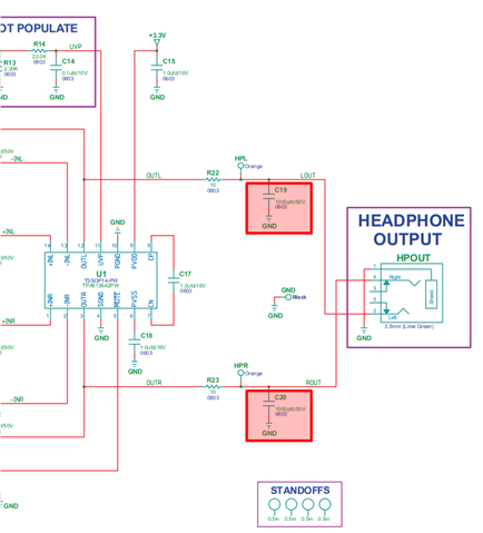

Part Number: TPA6138A2
Hi All,
I have a question about the maximum load capacitance.
What is the maximum load capacitance that can be connected to C19 and C20 on the EVM below?
Currently, R22 and R23 are 33 Ω.
Ishiwata

Hi Ishiwata-san,
There is no capacitance limit as long as there is a resistor/inductor between the capacitor and the amplifier output.
