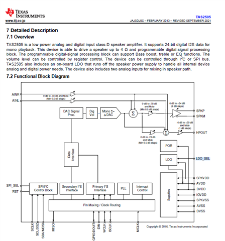

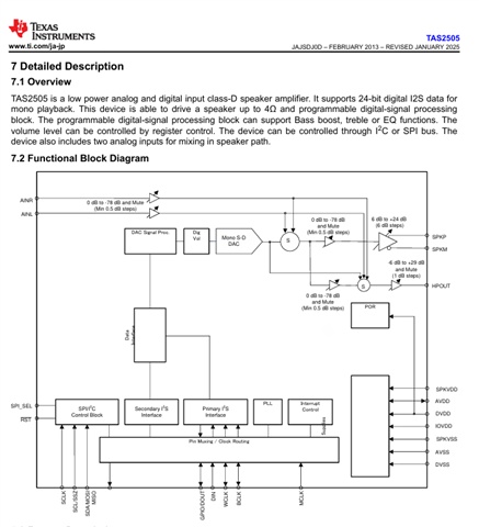

TAS2505: The internal LDO description has been removed from the datasheet.
Part Number: TAS2505
In datasheet RevC → D,
the block diagram does not include an LDO and it says that LDO_SEL should be connected to GND.
The built-in LDO can still be used, but is it correct to understand that its use is not recommended?
Rev.C
Rev.D
  • Hi Dai,
    The integrated LDO can be used with TAS2505 material labeled as rev C.
    We'll update the data sheet to remove the mentioned limitation on LDO functionality.
    -Ivan Salazar
