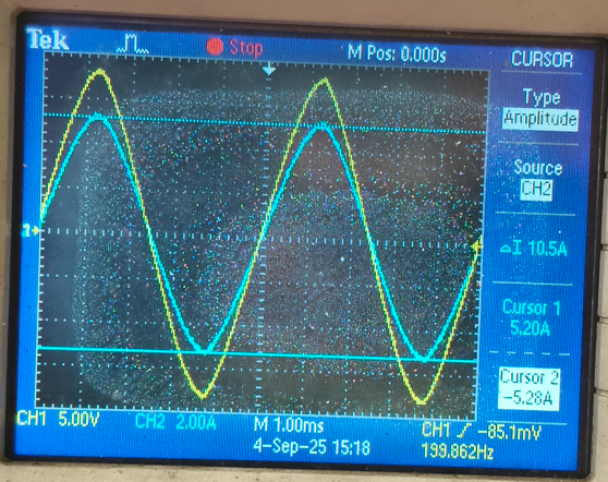

During testing, we observed the following behavior:
  • At 200Hz input, with 588mVpp (208mVrms) signal, the output measured 36.4Vpp (12.87Vrms) and 10.5Ipp (3.71Irms).
    • This results in an effective gain of approximately 35.8dB and a calculated output power of 47.7W.
      The waveform appears clean and consistent at this frequency.

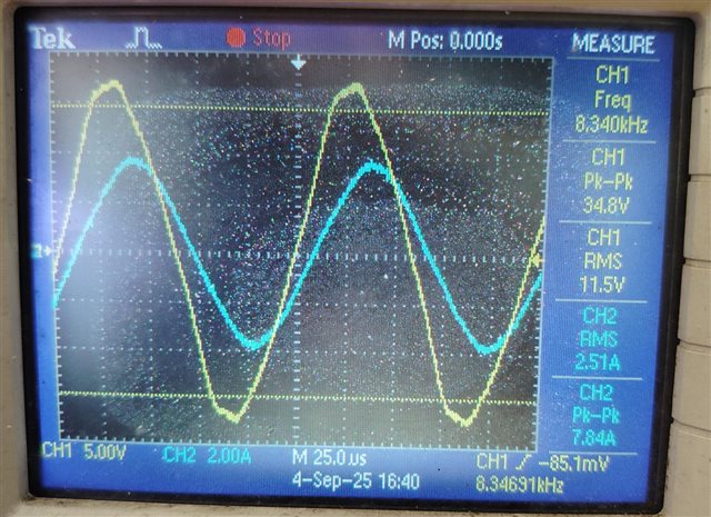

      • However, when the input frequency is increased to 8kHz, we noticed:
        • A reduction in output wattage
        • A phase difference between voltage and current waveforms
        • Distortion in the voltage waveform shape
        We have attached the relevant waveforms for your reference.

  • Hi Hari
    It's most possibly the high order harmonic been amplified by the output LC filter and your load side inductance. Only voltage waveform will be clearly affected. The load 33uH+4ohm is very large impedance under high frequency, so the current will be more clean, only the 8KHz fundamental frequency left.
    This phenomenon usually won't cause trouble, as the most of the high order are out of audio frequency band. If you could add the audio filter on the the output, like AES17 20KHz, you'll see the output is quite clean.
