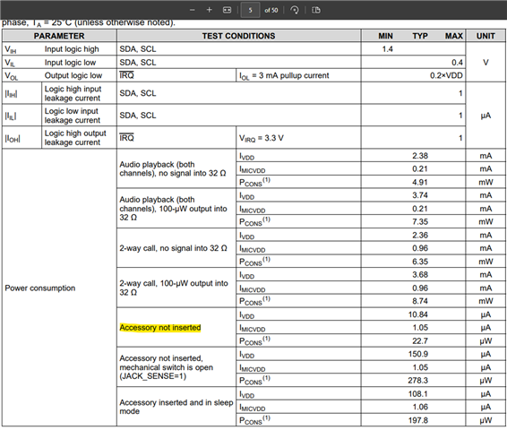

Part Number: TPA6166A2
I am considering using the TPA6166A2 for a 3.5mm Audio port. I would like to know the shutdown current as that is a key spec for our product. I couldnt find that in the datasheet.
rgds
rgds
Hi Srinivasan,
You can refer to the bottom of the table in page 5.
-Ivan Salazar
Applications Engineer
