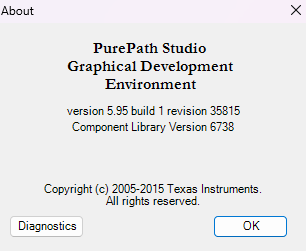

I am using Windows 11 and this is the Help->About window for my PurePath Studio install:

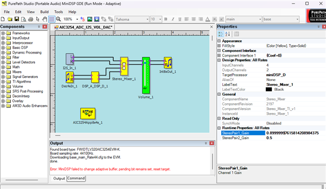

Screenshot below.  In this case I used AIC3254_ADC_I2S_VOL_DAC and tried to change StereoPair1_Gain from 0.5 to 0.9 in the Stereo_Mixer_1 component.

    Our expert is out of office and I'm travelling back to the office at the moment. I'll be able to look at this in more detail on Monday. I do know that these adaptive features are locked to the I2S clocks that carry the audio. Based on your description, there's no issues with playback and recording if the runtime properties aren't changed?
    Jeff McPherson
  • Oh! I forgot my USB-MODEVM had the switches set so that the USB I2S and USB MCK are off and provided externally and I wasn't providing them. That's probably the issue. I'll test and mark your reply as the resolution if it's successful. Thanks!
