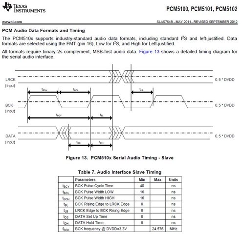

Could you tell me about the I2S timing requirements?
If you have any documentation similar to that provided for the PCM510x (attached file), please provide it.
Ryu.
  • Hello Ryu,
    For some reason  this table is missing in this datasheet . However, if you refer to datasheets for PCM510x family or  PCM5242,  these specs are identical. In the absence of official table, I would use the same table for PCM5121 as reference.
