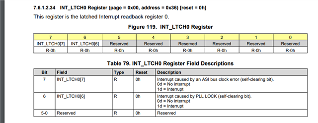

    Can you check the interrupt register to see if a clock error is happening?
    Another debug option that could help is to power up a single ADC (MID or TAIL) to see if the issue sits in configuring a single codec or if the issue is around both being up at the same time.

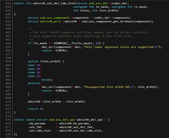

  • Hi Colin,
    The only thing I can think of is if the driver is not correctly shifting the audio on the MID and TAIL codecs to the 3/4 and 5/6 slots on the TDM bus. But I am not an expert on the driver. Our engineer who is more experienced on linux will be back tomorrow and he can take a look at this as well.
    Jeff McPherson
  • Thanks Jeff. Investigating further here - I'm wondering if the linux "simple sound card" can't support the daisy chain and if a more custom ASoC driver is necessary for this configuration. Colin
  • Hi Colin,
    I found this in the driver file:
    The adjacent slots starting at the first slot may be the issue - it may not want to start at slot 9 on device 2 and etc. You may be able to edit the driver yourself to override this or implement your own workaround. Sorry about this.
