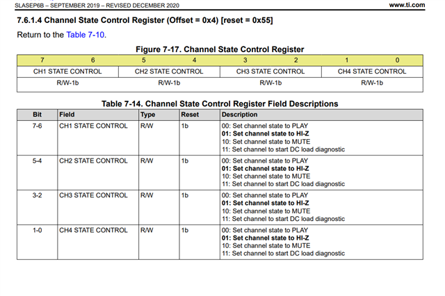

We have integrated the amplifier TPA6304-Q1 into the ECU. During the forceful shutdown of the ECU, there is audio disturbance observed from connected speakers through external amp speakers. After doing the analysis found that issue caused due to noise introduced in amplifier. Can you please suggest how to prevent the noise during the shutdown? We have tried muting of the amplifier during the shutdown, but it is not helping.
Attached is the pic showing the noise generated on the amplifier.
