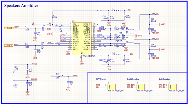

However, we are not able to get voltage at MICBIAS & not getting audio at headset playback.

Schematic of hardware design is available in support ticket below. We have also attached device tree for review.

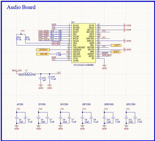

  • Hi Mir,
    We are not receiving power at the MICBIAS voltage on pin 12.
    MIC:  arecord -D hw:0,0 -f S16_LE -r 48000 -c 2 -d 5 --buffer-size=4096 --period-size=1024 mic-test.wav
    Command is executed with no error.
    Additionally, there is no analog output signal at the headset pins 27 (LOUT) and 30 (ROUT).

  • Hi Dharmendra,
    Do you not have any voltage coming out of MICBIAS? I wonder if the device is not reading all the associated .h files for the DTS config - it should be 2V by default out of MICBIAS, and I see you have set it to 2.5V. You can read this previous E2E about this issue:  TLV320AIC3100: TLV320AIC31XX-LINUX driver, Issues setting up mic bias, Raspberry Pi 4
    You may also need to add the audio-routing property in the DTS file as described here: https://www.kernel.org/doc/Documentation/devicetree/bindings/sound/tlv320aic31xx.txt
    This would look like simple-audio-card,routing = like in the simple-card documentation: https://www.kernel.org/doc/Documentation/devicetree/bindings/sound/simple-card.txt
    But with labels like "HPL" and "HPR" and "MIC1LP" as defined in the aic31xx.txt file.
    Let me know if this helps! I would think the routing may also be affecting the mic bias, if there is no mic routed then maybe it will not turn on the bias to save power.

  • Hi  ,
    Thank you very much for your continued support.
    Using the routing you suggested, we are able to get the MICBIAS voltage at 2.5V.
    However, we are still unable to capture audio from the microphone with the following command:
    arecord -D hw:0,0 -f S16_LE -r 48000 -c 2 -d 5 mic-test.wav
    Could you please confirm which pins are responsible for the microphone input?

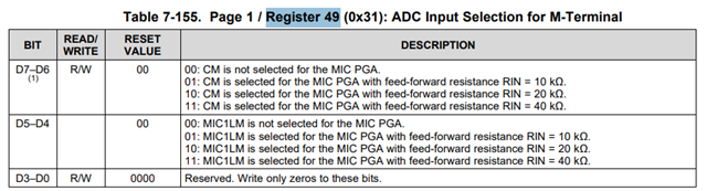

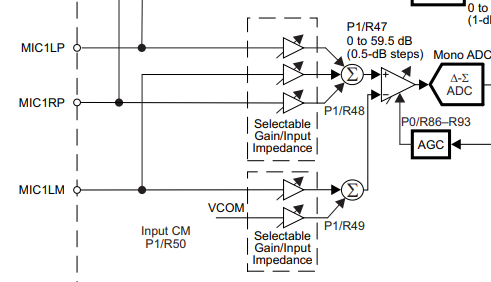

  • Hi Dharmendra,
    The microphone input is set to MIC1RP according to your DTS routing, although this is just the P terminal, typically you need both the P and M terminal to the PGA. I see for the M terminal of the PGA, it is just MIC1LM connected, and since you have this floating on your schematic, you will need to use software to configure the MIC1LM as connected to a common mode VCOM. It may not fully be supported in the driver right now, but here is what I found, I think we can either add a few more lines to the aic31xx.c driver file or check what is present in the amixer GUI...
    This is the register that needs to be changed to rout the M terminal of the PGA to VCOM, page 1 register 49 bits 7-6:
    We see in the tlv320aic31xx.h file that page 1 register 49 is defined as "AIC31XX_MICPGAMI":
    Searching for this in the tlv320aic31xx.c file, it is mentioned 3 times:
    First in the defaults section:
    And then twice here:
    So, we are looking for the cm_m_enum to define which DTS file entry corresponds here. However, "cm_m_enum" is only mentioned once in this file and it is here. Meanwhile, mic1lm_m_enum is mentioned like this:
    So, to change the common mode setting intuitively with the driver, we would need to add an equivalent snd_kcontrol_new entry for cm_m_enum, something like this:
    Then, we could target the common mode connection in the dts routing file similar to what you have already done for "MIC1RP P-Terminal".
    ALSO, note that you will need to include one of these settings for the mic selection to work, even for your MIC1RP P-Terminal:
    I believe these are the sort of things that should populate in amixer, the GUI is called alsamixer. Please check that before you change anything in the driver, I am sorry if I made it more complicated. If changing alamixer or the DTS does not help, we can try changing the default register values as well. Please send over a screenshot of your alsamixer settings that you see, and if you can take a register dump during recording that will be helpful as well.

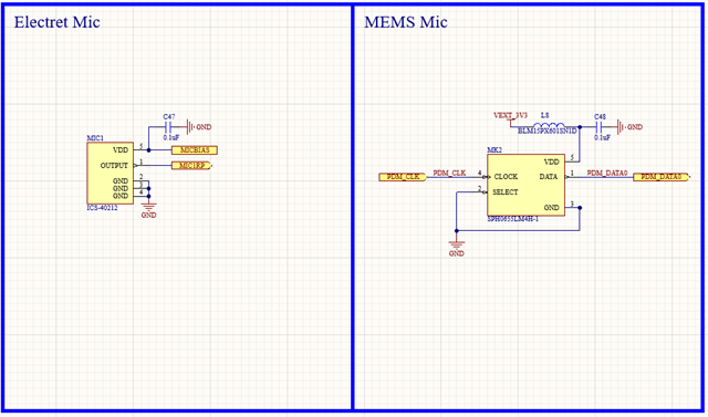

    If there are any other compatible microphones available, please let us know so that we can proceed with redesigning the layout accordingly.
    We required microphone with strong noise cancellation capabilities to ensure optimal performance.
    We are currently facing challenges with the integration of the electret microphone.
    It is critical that we finalize the microphone selection at the earliest so that we can move forward with production.

  • Hi
    We are getting volage on MICBIAS of mic when we try to record using mic.
    but when we probed MIC1RP - there is no signal while we are speaking on mic.
    Can you please help to debug this issue (BTW we are using ICS-40212 mic) ?
    Thank You
    Dharmendra Savaliya

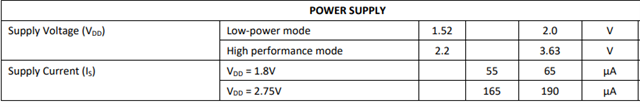

    Can you verify that your MICBIAS is within these ranges from the mic datasheet, in relation to the mic ground connection:
    Mir
