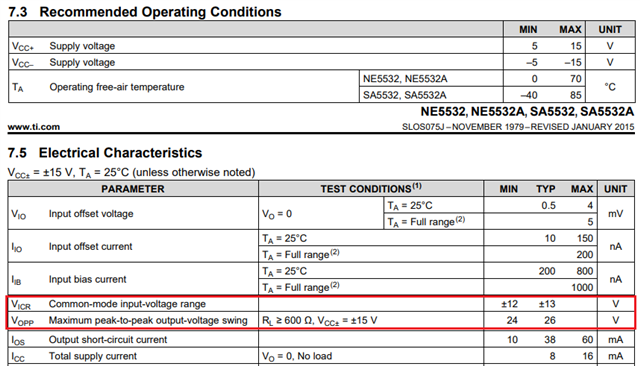

Dears,
The NE5532 from ASO Mexico, with an input voltage of 16.5V, may cause IC burnout. Please help investigate the reason,thanks.
  • Hi Li Ning,
    Can you tell us the circuit's supply rails? Please also provide me with schematic. It is not clear what you have.
    Also, the input Vicm voltage is from ±12V (min) from ±15Vdc rails. Please make sure that you are not exceed the design limits, including capacitive load at the op amp's output without compensation.
    If you prefer to contact me privately, please post "friendship" request via E2E forum. We can discuss the matter in the E2E private messaging platform or via TI's internal email.
