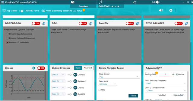

I have a question about the TAS5830.
Is the EQ set automatically? Or is it user-configurable?
If it is user-configurable, which registers should I set?

Hi Ishiwata,
please use PPC3 tool to configure the EQ/DRC/AGL etc..
and the tool will generate the required parameters to a file.
please goto below link
https://www.ti.com/product/TAS5830#software-development
and use the request button to request the tool.
