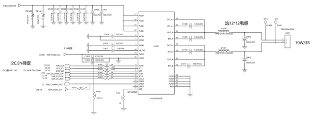

Dear TI Support Team,
We are currently designing a system using the TAS5830 and would like to request your assistance in reviewing our schematic to ensure correct implementation and avoid any potential issues.
The schematic is attached for your reference.
Thanks!
  • Hi
    the SCH seems fine.
    but there are two comments:
    1 it seems it will use class-H, there should be RC filter design, it doesn't show here.
    2 the goio0/gpio2 are floating, and there are no fault/warning connections, suggest to add them or test points for debug use.
