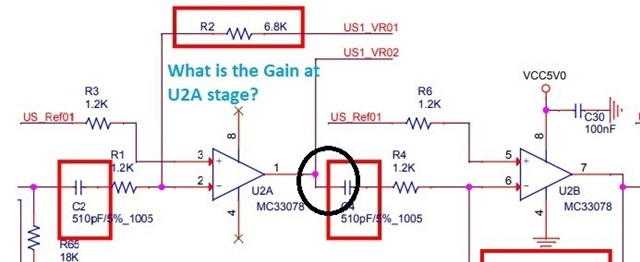

Hi Team,
There is the oscillation issue on the output of MC33078. The failure rate is about 7%. Please check the schematic below and let me know your review result and the cause of this issue.
(The output frequency of MA300D1 is 300kHz.)
Schematic_MC33078.pdf

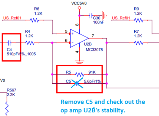

    In addition, where MA300D1 are you referring to? Please remove C5 of 5.6pF that is paralleled on top top R5 or 91kohm. After it is removed, please let me know if the oscillation is disappeared.

  • Hi Raymond,
    Let me check a top marking image with customer and send you it.
    MA300D1 means RS1 in the schematic and it is proximity sensors. Let me check your recommendation and I will let you know if this issue is cleared.

    And the customer already replaced to new IC, so unfortunately can not be tested for removing C5.
    Can you clarify the above statement? The output frequency of MA300D1 is 300kHz - what is actual input signal's frequency? 300kHz may refer to the op amp's cutoff frequency. Please let me know.

  • Hi Jeffrey,
    The op amp is unable to support 300kHz actual input frequency based on GBWP. You circuit gain is 1 + 91/1.2 = 76.83V/V and GBW = 16MHz, the cutoff frequency for the configuration is approx. 16MHz/76.83 = 208kHz, which is unable to support 300kHz input signal - That is the reason that I am asking. In other words, the output signal may be gained up, but also attenuated significantly at 300kHz.
    For actual 300kHz input signal, the op amp's cutoff frequency should be allocated near 3MHz, a decade higher. So the circuit is not going to work as designed, if you input signal frequency is 300kHz. What is the circuit application?
    there is the oscillation issue even it is pre-PCN MC33078.
    Could you tell me which output node is oscillating?
    Raymond

  • Hi Jeffrey,
     Could these circuit configurations cause oscillation?
    Could you send me a screen capture of the oscillation? Your schematic marked two 4 spots, It is not clear which stage has the oscillation?
    Raymond

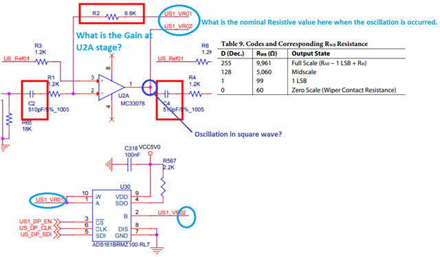

  • Hi Raymond,
    The black marked spot(Pin 1 of U2A) is the oscillation one. They said that the oscillation waveform is square waveform(no frequency information) swing 0V to 5V, but they have not a screen capture of the oscillation. And they said that the real cutoff frequency is more than 300kHz because of using Vcc=5V. Also, they use this OPAMP on all of models, and there is this issue on only 7 devices of 100 devices.
  • Hi Jeffrey,
    Per your description, the only possibility is that V0R1 and VR02 terminal connections are open, then the op amp's node will have square wave between 0 and 5V. The reason is that U2A is configured as comparator, if V0R1 and VR02 is not connected.
    So the question is what is resistive value between  V0R1 and VR02 nodes under the observed oscillation. Please let me know.
    Raymond

  • Hi Raymond,
    They said that V0R1 and VR02 terminal connections are not open even though they couldn't check the exact resistive value between both because there is no board occurred the oscillation. As a result, they decided to change OPAMP from MC33078 to LMH6643.
