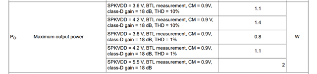

When SPKVDD=5V and an 8Ω 2W speaker is at maximum volume, what is the average DC current supplied to SPKVDD (Ispkvdd)?
This EVM board can be used with a USB 2.0 port, so I'm assuming Ispkvdd is less than 500mA, but is this correct? Please let me know if you have a formula for calculating it.
