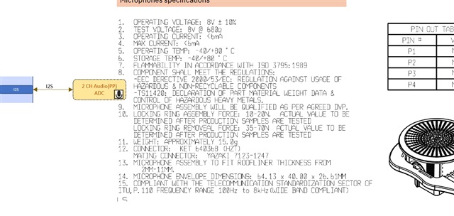

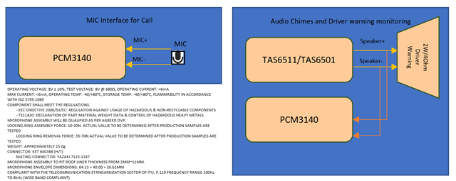

Dear Team, we need to interface MIC for to system for hands free application for instrument clusterMIC Interfacing for hands free. Please let me know suitable IC. We were thinking of PCM60202Q1. But need to check for single channel IC also. Attached is our mic and interfacing arrangement. Please suggest.

    2. This is second query; I have one audio amplifier out which is to be monitored for Chimes. Can you suggest any circuit which amplifier out to be given to one channel of PCM3120. Amplifier out could be up to 2 to 3W for chimes in vehicle.
  • Hi Manoj,
    Which amp have you selected? As long as the voltage is below 2Vrms differential, the PCM3120-Q1 can measure it fine. The ADC can be connected parallel to the speaker load.
    Jeff McPherson
  • Hi Jeff.
    1. I have two requirement one i s MIC interface for calling.  MIC spec is given.
    2. Speaker feedback is to be monitored. I have used TAS6501/TAS6511 amplifier for Audio warning.
    Please provide single channel IC as we may need only one channel on some variant.
    Also confirm if in PCM3120-Q1 (Dual channel) One channel could be used feedback form speaker and other channel could be used for MIC interface. Our host interface is I2S.
  • Manoj,
    There is no mono ADC that will work for you here. Most of our catalog is 2 channel minimum.
    For a 2W output to 4ohms will be about >3Vrms which is higher than the 2Vrms maximum of the PCM3120-Q1 ADC. The PCM6020-Q1 would be better for this, despite the tradeoff on mic dynamic range.
    However the TAS6511/TAS6501 can output current sense data via I2S. I think you will be better off not using any external circuitry to sense the output since the amp can do that on its own. Then the ADC can be used for the mic only.

    2. It provide diagnostic for Open/Short input. Short to GND, MICBIAS VBAT. Need to check for 24V short to Bat case protection using external components. During schematic review you can suggest these components or any protection IC for the same.
    Please share development board schematic.
     3. Query: As our MIC is 2 Meter away from board, would MIC+ and MIC- would be directly connecting with INP and INM pins of of PCM 60202 through AC coupling.
    4. We may need your support for schematic review. Request you to connect over email.

    Attached is MIC spec. Also we are dring MIC baising from IC itelf, MIC boasing is 8V.
