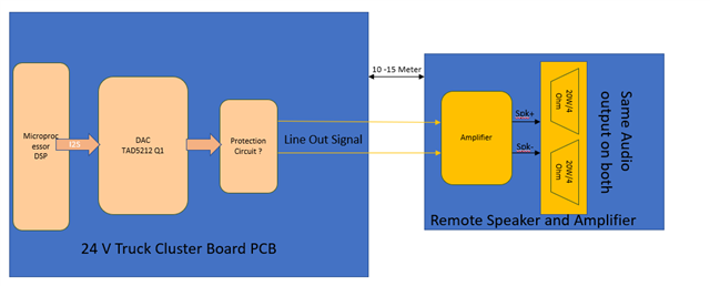

I need protection advice for 24V system for Short to BAT and other 3A 3B test for Lin out signal for driving external speaker.

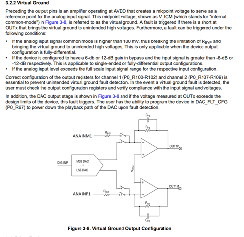

Hi Manoj,
Please see section 3.2.2 of the fault diagnostic app note. https://www.ti.com/lit/pdf/slaaed9
This will protect the dac outputs from short to supply
Hi Deveon,
Understood for short to bat. Please see attach BD and let me know if TAD5212 is best choice for this application (24V system Cluster). We consider output would be line out. Also need reference schematic for this.
