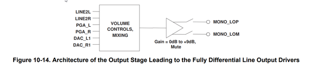

HI
I'm planning to use TLV320AIC3106 this for our HMI based design using AM625x. We need to connect speaker and microphone to this audio codec. The datasheet has mentioned TPA2012D2 as the class D amplifier.However we want an amplifier which can integrate both right and left and be connected to a single speaker. Please suggest a suitable amplifier. We cannot accommodate 2 speakers inside our HMI enclosure and hence want a single speaker design.
Also kindly suggest a suitable part number for microphone.
