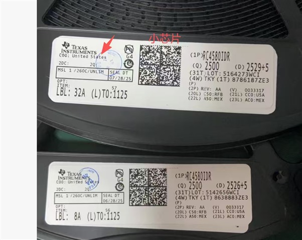

we find one issue about current in customer side, there is 17mA output current in failed chips, while normal device is 7-8mA current.

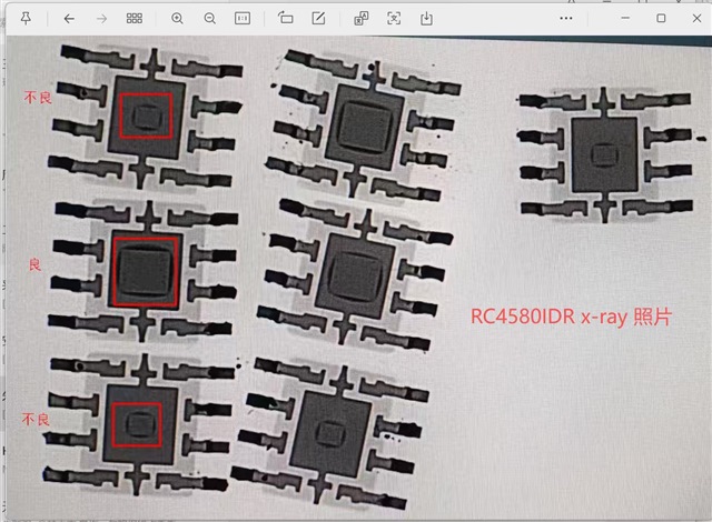

also we check the X-Ray, finding device include small and big die? Why and what is the difference?
support need:
  • what is the difference between small size die and big one? we have 30% failure in small one
  • we use multimeter to test chip impedance(remove from board) of Vcc+ pin 8 and Vcc- pin 4, find both good and bad Vcc+ to Vcc- is 617-668 ohm,  Vcc- to Vcc+ is 1380-1900 ohm in good chip; Vcc- to Vcc+ is M ohm in bad chip. what is the normal impedance range for Vcc+ and Vcc-
RC4850 device under X-Ray:
DC code and lot number: (top is bad one, bottom is good one)

  • Hi Chi,

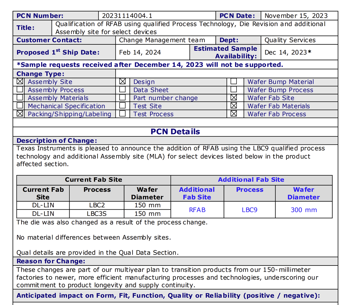

    This is most likely related to the product change notification that was sent out on November 15, 2023.
    Product Change Notification
    The RC4580 was redesigned and also changed fabs to RFAB, detailed below. We have been seeing a trend at contract manufactures that do in circuit tests or ICT tests where pins are measured for resistance and when they see a difference it is noted as a failure. More often than not this is just an observation that something has changed between the old device and the new device, however it isn't necessarily causing an application circuit problem. The new device was designed such that it will meet or exceed the old device specs. In the rare instance that something was worse we would update any spec to the worst spec.
