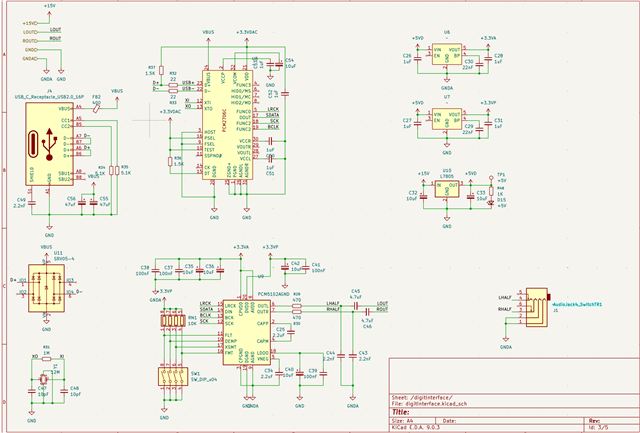

Hello experts,
Sorry for bothering you about this problem.
I am working on an early stage of a personal audio device, based on PCM2706/PCM5102 and OPA1622. But right now, I am in trouble with the audio output of both devices. I can't get any sound on both the PCM2706 audio and PCM5102 analog output interfaces.
I attach my schematic of the USB audio interface and welcome any suggestions and comments.
I haven't set the labels on the PCM2706C analog interface, but I used wires connecting this output interface and the amplifier, no output.

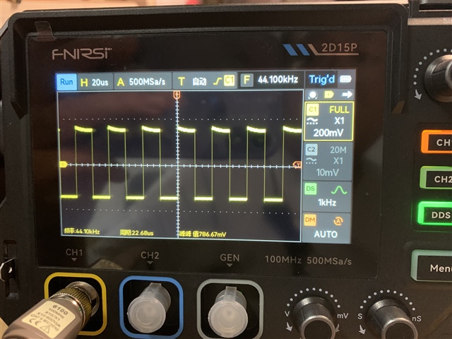

    1. System can identify the USB device, but I'm not sure whether it's working properly.
    2. I can see the correct I2S data on Pins
    3. Pin set:
    - FLT = low
    - DEMP=low
    -XSMT=high
    -FMT=low
    4. PCM5102A Pin 18 no voltage, expected ~1.8V
    5. PCM5102A Pin2-4 charge pump no voltage, excepted -1.6~-1.8V
    6. PCM5102A has replaced
