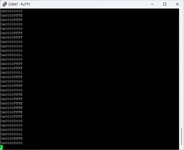

However, when I want to read the audio signal from Codec through I2S, I mostly read FFFF values.
Oscilloscope measurements shows the MCU is reading I2S properly (i.e. the transmitted signal by Codec is incorrect).
Can you help me to see what is the problem in my configuration?
