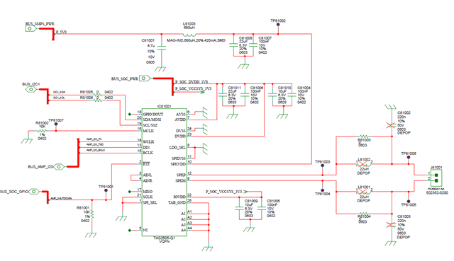

We are trying to integrate TAS2505 DAC with TI AM62Px SOC. Our connection is as follows and we use BCLK and MCLK is not using.
I tried example sequence in ti.com/lit/ug/slau472c/slau472c.pdf?ts=1759243187940 Section 5.1, but this is for setting with MCLK.
Could you please share the correct sequence to be followed for initializing DAC from SOC? The following is our connection.

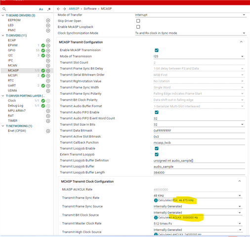

  • Hello  ,
    Thanks for the quick feedback. I am using TI SDK for AM62Px and the configuration in SysConfig is as follows:

  • Hello Ivan
    Thanks for the feedback. How this can be tested?
    This is our connection:
    Do we need to send a 1KHz square wave to DIN pin? How 1KHz sine tone can be given?
    We tried to generate a square pulse from SOC via DIN, but we are not seeing any sound.
    How we can test based on above circuit?
  • TAS2505 is a digital input audio amplifier. The host SoC should send digital signals in I2S or other audio format. A simple square-wave on SDIN won't work.

  • Hello Ivan,
    We measured the DIN pin of TAS2505 and we could see I2S data is being send from AM62Px SOC via MCASP Peripheral. But we ae not able to see any audio in the speaker output.
    One change we could notice is in 0x00/0x1B register, Audio Data Word length shall be 32 bits, since We set 32 bit in the SOC MCASP configuration. (See the image in 2nd comment) - Is this correct?
    Any other settings we need to check?
    Could you please check and confirm?

  • Hi Rakesh,
    Yes, you can set register 0x1b to select 32-bit and try again.
    If you capture BCLK and WCLK as well, do they match your description from the 2nd comment?
    You can use a scope to inspect the Class-D output, TP81003 or TP81004 can be used. Is the output switching as a PWM? Or is there no signal at all?
    Please also read Page 1 Register 0x2d, does it show speaker output enabled?
