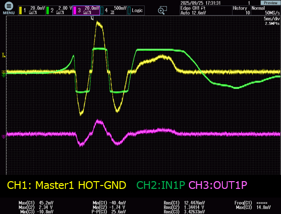

The audio signal input from the ADC is not being sent from the DSP to the DAC, yet a signal is being output.
Despite the MIC being OFF (no audio signal being sent from the DSP), the signal input to the ADC is being output.
The input format is the same as in Figure 7-15.
The waveform is attached below.
As shown in the diagram, when the ratings for IN1P and IN1M are exceeded, signals are generated only at OUT1P and OUT1M.
When an input exceeding the rating is applied, what operation is specified as the intended behavior?
Is there a possibility that signals could leak only from the DAC side CH?
The register settings are as follows.
