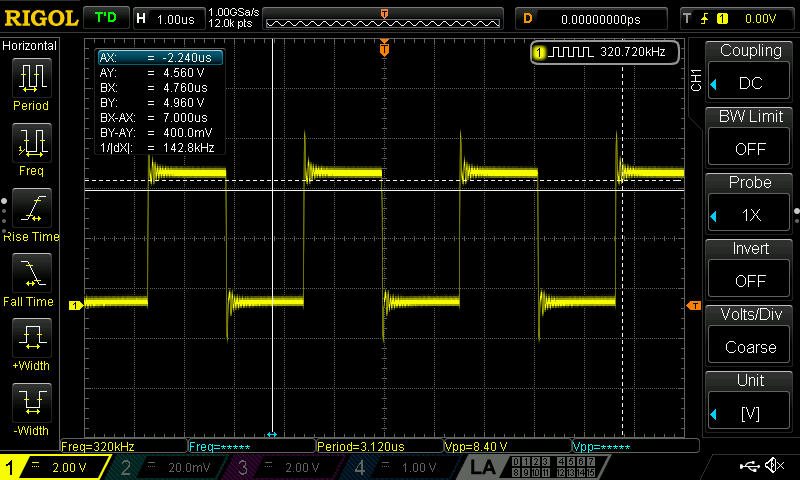

  • Are you providing MCLK, BCLK, and WCLK? Or just MCLK? Can you measure the clocks at the pins on the codec? Another thing to check is when these I2C commands are sent to initialize the codec, maybe the reset is not occurring on startup. Can you also measure the I2C pins when you start up the Pi?
    -Mir
  • I am only providing the MCLK right now, and it is has a frequency of 11289600 Hz. When I start up the Pi and look at the I2C pins on my logic analyzer the commands look like nonsense, they do not follow the structure of start -> address -> data -> stop that I saw when communicating with the codec board over the CodecControl software and are all random. Because of that I would not be surprised if reset is not occurring on startup.

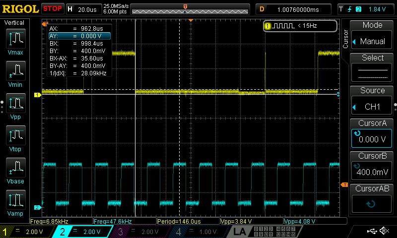

  • I should correct myself, after I managed to get the MCLK working and reverted back to the overlay included in the original post the error messages in dmesg disappeared, but I am still unable to hear anything out of the codec upon running aplay, and the I2C messages that are sent on the bus are when aplay is run are nonsense do not follow the correct structure.
    Can you share a schematic? I2C messages being nonsense seems strange. Maybe you need pull ups? Can you verify that the correct pins are being used on the Pi and they are configured for I2C? Can you make sure the grounds are connected? (connect grounds before you worry about pull ups)
    -Mir
  • Mir,
    Sorry but I do not have a schematic as I am currently just directly wiring the pins of the Raspberry Pi 4 to the accessible test points on the acev-1b board. This wiring setup is in the original post. I am sure that both the ground of the Pi and the acev-1b board are connected. The pins on the Pi are definitely set up for I2C, I know this from both the results to pinctrl on the Pi showing that the pins are set to I2C and not inputs, and from observing the signals when i2cdetect is run on a Logic Analyzer, where the results are as expected.
    Thanks again,
    Caleb
  • I should also add that I know that the I2C lines idle high, so I do not think pull ups are needed. Do you think anything is wrong with my overlay file or driver code?
    Caleb

  • Mir,
    Sorry for the late response. The issue with I2C includes at least two of the writes, one of which is shown in the image. There is one write where it writes to register 0x3F which is the DAC data-path setup register with the value of 0xC4. However, in the datasheet bit 3 is reserved at 0 and yet is overwritten with this command. It also writes to register 0x25 which is the DAC flag register with the value of 0xBA. However, in the datasheet bits 0 through 3 are reserved and not supposed to be written to. Also, I changed MDAC and MADC to 2 in reg_defaults, but after rebooting the computer this did not cause registers 12 and 19 to have 0x02 written into them instead of 0x01 when looking through i2cdump for some reason.
    I am including the scope captures of the I2C lines here (yellow=SDA, blue=SCL), but I think I need further clarification on how to get a scope shot of the analog signal? I got the capture of it (last included image) I am including here from probing SPLP but I am not sure if that is what you were referring to. Please let me know any additional clarifications.
    Caleb
