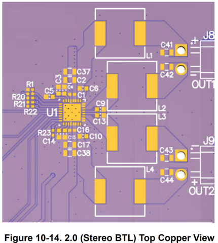

    4. Thermal Vias
    There should be more vias here from the thermal pad to GND, this will hlep to transfer heat to the ground plane. Here's a snippet from the layout guidelines:

    With no audio input the output will be switching at a 50% duty cycle, and the switching losses of the amplifier will be dominant. With a 24V supply this will this will generate alot of heat. Even if testing at room temp of 25C, the heat generated will be much higher due to power losses (mainly switching with no input).
    I suggest comparing the EVM with the customer board. The EVM uses many more thermal vias to connect the thermal pad to GND.
    Increasing copper thickness will also help with heat dissipation.
