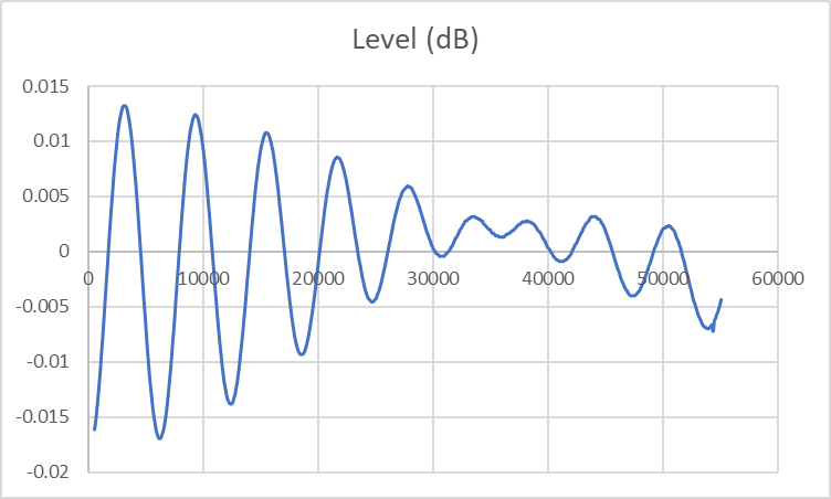

We are currently using SRC4392 into our design, andwe have an issue with the frequency response of SRC4392.
SRC4392 is used with the following configuration
  • DIR -> ASRC -> PORTb
  • Slave mode, LRClk=192kHz, BClk=12.288MHz, MClk=24.576MHz
  • Input sampling frequency 192kHz
If we disable the ASRC with synchronised frequencies, the frequency response is flat.
If we use ASRC, we have following :
In datasheet p5, we have digital interpolation filter ripple +/- 0.007dB max and digital decimation  filter ripple +/-0.008dB max.
How were these figures measured?
