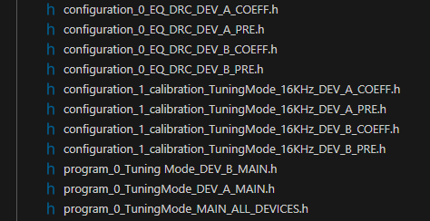

    3. The required files are:
      1. configuration_0_EQ_DRC_DEV_A_COEFF.h
      2. configuration_0_EQ_DRC_DEV_B_COEFF.h
      3. program_0_TuningMode_DEV_A_MAIN.h
      4. program_0_TuningMode_DEV_B_MAIN.h
      5. program_0_TuningMode_MAIN_ALL_DEVICES.h

    2.what is the difference in below files (main and main all):
    1. program_0_TuningMode_DEV_A_MAIN.h
    2. program_0_TuningMode_DEV_B_MAIN.h
    3. program_0_TuningMode_MAIN_ALL_DEVICES.h

    1. I would suggest finding a way to keep VDD power on, this way the memory is not cleared. In SW shutdown the consumption from VDD is ~10uA and from VBAT is ~1uA (included in data sheet "Typical Current Consumption" table).
    2. MAIN_ALL_DEVICES file includes settings that are shared across device A and device B. If you're using a single device, you'll have a single program_0_... file.
