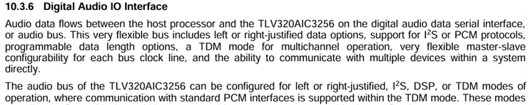

I can supply the TLV320AIC3256 with the MCLK signal from a 12MHz oscillator, while the WCLK and BCLK signals are supplied from the host MCU.
Would a frequency of 12MHz be fine, or should I use another frequency, such as 12.288MHz?
As an alternative, can I leave MCLK disconnected and use PCM instead of I2S?
Thanks very much.
Best regards.
    12.288MHz would be preferred since it is an audio multiple.
    This device only supports I2S, it does not support PCM.

    So, can I supply MCLK from an external oscillator with a frequency of 12.288 MHz?
    I am a little confused about PCM because section 10.3.6 of the datasheet says that it supports PCM. Could you please confirm this for me? This is an important point because the host I am going to use is PCM.
