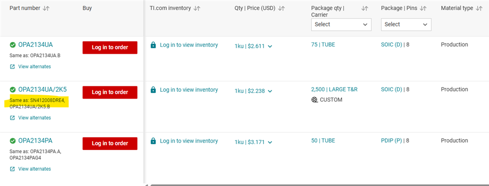

  • Hi TI Team.
    One more question jump into our attention and is why on PCN# 20231219018.1 MPN #SN412008DRE4 is not referenced for the die change?  If  MPN's  OPA2134UA/2K5 & SN412008DRE4 are searched on Texas Instrument website both get directed to the same page for MPN #OPA2134UA/2K5 and is called as the same component.
    Thanks.
  • Hi Ramon,
    Yes, the SN412008DRE4 is the same part as OPA2134UA/2K5. If you go to the OPA2134 product page, you can see that you can only order the OPA2134UA, OPA2134UA/2K5, and OPA2134PA, but that SN412008DRE4 is shown as the same orderable part as OPA2134UA/2K5. That is why it is not shown as a separate device on the PCN.
    Carrie
