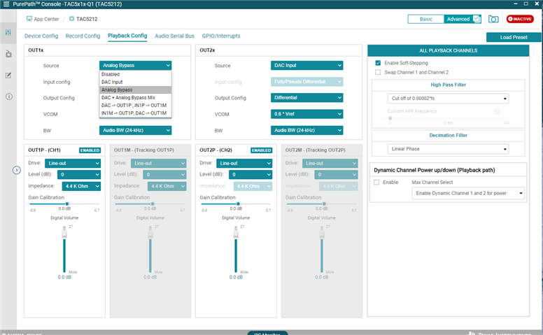

    2. Use as (AA) converter, with analog input signal and TAC5212 inserting adjustable gain.
    This is achieved with the Analog Bypass feature, selectable on the Playback Config window:
    Gain can be inserted with the Digital Volume slider shown here.

  • Hi Garret,
    I just tested the Analog Bypass mode.
    Testsignal input sinusoid, 5 kHz, 100 mVolt pk-pk.
    Output differential on OUT1P / OUT2P
    Level (dB) selector 0 dB -> output measured ok / 100 mV pk-pk
    Selecting -12 / -6 dB / +6dB level adjusts the output as expected.
    ( I think the Digital Volume slider does nothing in this configuration?)
    But +12 dB creates a spiky mess (pulses at 20 microsec) , and +18 / +24 dB seem to switch off output.
    I tried this with various Drive/impedance settings and also different loads on the output, but nothing seems to make a difference.
    Is this expected behaviour, or am I messing something up?
    Harry
  • Hi Harry,
    This is expected, +18 and +24dB are not actually available configurations in the register map:
    I am not sure why they still appear in PPC3.
    Garret
