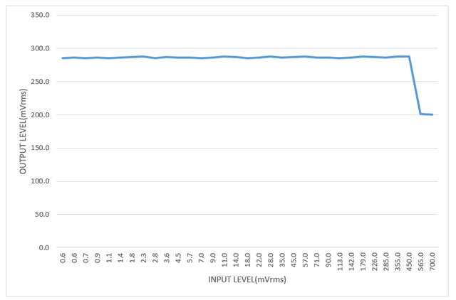

    Even when changing the target gain setting, the output level is approximately twice the expected value.
    The results are shown below.
    Target gain: -8 dB / Output: 616 mVrms / Expected: 281 mVrms
    Target gain: -14 dB / Output: 285 mVrms / Expected: 141 mVrms
    Target gain: -20 dB / Output: 143 mVrms / Expected: 71 mVrms
    Kind regards

    With this same hardware configuration, enabling AGC produces the following results.
    Target gain -8 dB / Output 616 mVrms / Expected 281 mVrms
    Target gain -14 dB / Output 285 mVrms / Expected 141 mVrms
    Target gain -20 dB / Output 143 mVrms / Expected 71 mVrms
    When AGC is enabled, I understand that the AGC function automatically adjusts the PGA gain.
    However, the adjusted result becomes more than 5 dB higher than the expected target gain level.
    Therefore, I believe the AGC is intentionally producing a higher output level than expected for some reason.
    I understand your explanation that the difference between average and RMS values is included in the AGC algorithm.
    An 11% difference corresponds to approximately 1 dB, and I agree this may be one contributing factor.
    However, the measured result shows approximately 80% difference, corresponding to more than 5 dB deviation.
    (Example: Target gain -14 dB / Output 285 mVrms / Expected 141 mVrms)
    Therefore, I believe there must be another factor in addition to the average vs RMS difference.
    Could you clarify what that factor might be?

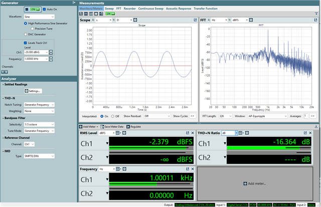

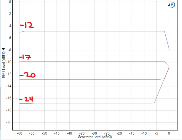

    I tested today and am seeing something similar to you. I think there are a few things at play here, and we can do some more testing to narrow it down if you would like. First, it seems like the noise threshold is not correct, and is off in dB by a factor of 2 or 3, or maybe it just is set to one level, which I was measuring to be around -45dBFS (wrt 0.707Vrms as the full scale on the ADC single ended). At this input level, the AGC seemed to stop being engaged. I tested this with the noise gate at -30dB and -90dB and saw it behave the same for either setting.
    Another thing I noticed was that there were levels to the AGC behavior, where the input level determined what the output was, even within the range when the AGC was enabled. So, firstly, I noticed that the output of the ADC when AGC was enabled was typically around 6dB higher than we would expect based on the "target level", so that is likely where you are seeing that ~5dB increase. But I was also seeing these levels change up, and there was only a small range in the inputs that led to the expected target level + 6dB being the output of the ADC. I did this sweep so you can see: we see that at -45dBrG (dBFS if we say ADC input 0dBFS is .707Vrms), the output jumps up to ~-4dBFS, which is -10dBFS + 6 (I have the target set to -10dBFS right now). Then it stays until around -33dBFS analog input, and it scales upwards until we hit around -26dBFS when it jumps down and scales upward until we hit -20dBFS when it gets stuck at -2dBFS output. This behavior being stuck at ~-2dBFS was seen with multiple target levels, it seems like maybe this is when the input goes OVER the target it needs, since it is extra distorted. Again I am not sure about how the algorithm actually works I just wanted to share with you that I am seeing this, and check if you are seeing this same behavior as well, so we can be on the same page.
    ^ when the output switches to the high gain -2dBFS output, when input hits ~-20dB
    ^ before it goes to the -2dBFS output, we see ~4dB output which is -10dB target level plus 5 or 6dB
    I will attach my code as well, I was using your script with a few changes to the clocking since I was not sure what you had set register 0x03 to and was using 12.288MHz MCLK, but not sure your MCLK.

    I also performed a sweep test.
    However, please note that the target gain setting in my test differs from the condition discussed in my original question.
    Also, due to measurement equipment limitations, both the input and output measurements are analog signals.
    In your test, AGC disengagement was observed at low signal levels.
    I could not confirm that behavior on my side.
    However, I believe the reason is simply that my measurement equipment cannot generate sufficiently low input levels.
    In my measurements, the AGC remained active over the entire input range, and the output level stayed nearly constant.
    Also, this output level is higher than the configured target gain, which is the issue I am investigating.
    I believe your measurement results and mine are consistent in many aspects.
    1.In your measurements, the transition from approximately -45dBrG to -2dBFS appears to indicate that the AGC became active.
    There may be discussion regarding the input level at which AGC becomes active, but I do not believe that point is strongly related to the main issue.
    2.In your measurements, from approximately -43dBFS input up to 0dBFS input, although there are some partial level reductions, the output remains approximately constant at -2dBFS, which suggests that AGC is operating.
    Also, since this is approximately +6dB higher than the target setting of -10dBFS, I believe this behavior matches the phenomenon I am observing.
    There are also some differences between our measurements.
    1.In your measurements, the level drops toward approximately -10dBFS around -25dBrG, but I could not observe this behavior in my measurements.
    One possible reason may be that our measurement points are different.
    You mentioned that you are measuring the ADC output, so I assume you are observing the digital data after AGC processing.
    In my case, I am measuring the analog signal after the digital data passes through the DAC.
    This difference may be one contributing factor.
    2.In my measurements, the level begins to decrease once the input exceeds approximately 450mVrms.
    When I checked this using an oscilloscope, waveform distortion was visible and the peak voltage was reduced.
    Therefore, I believe the level reduction is caused by waveform distortion.
    In your measurements, I assume that 0dBrG corresponds to the target gain, so input levels above the target gain may not have been tested.

    I did this test again with both differential and single ended ADC configurations, just to see what happens with the AGC. I found that for BOTH single ended and differential, we see the AGC kick in ~6dB higher than we expect. So, I have the script set to -14dB threshold here, and AGC starts around -7dB (-8dB is 6 off, plus 1dB of difference for gain error plus averaging/rms difference).
    The curve on the left is the single ended signal, and curves on the right are differential (with one measurement taken with no AGC on, just to make sure we are measuring correctly).

    I want to update my original graphs - here is a reading of the AGC set to -24dB target and sweeping from -60dB to 0dB of input. In my previous measurement, I had not set all AGC parameters and had the timing wrong on my measurement software and it seemed like it was not applying gain, just reducing gain when the input was over the target. Now, I have updated the script and the output is more accurate, except for the 6dB offset. It seems like around -6dB generator level, the AGC cannot keep the volume down, and it increases linearly. I saw in this app note about similar devices (link) that the minimum PGA gain is -12dB, so this would make sense for the -6dB signal to be brought down to ~-18dB by the PGA, and then when the input signal exceeds that, it still has -12dB of gain but not more, so that is why the gain increases linearly at the highest ADC input levels.
    I then measured the AGC for various input threshold levels (changing register 0x1a):
    We see the same ~6dB offset on all of them.
    I saw at least 1 other E2E thread about this issue, but not as in depth as the discussion we are having here. I have measured on 2 different devices from the same family and seen the same response so I believe this is how the AGC algorithm works. From my various testing, I believe that this 6dB offset is from the AGC algorithm, not the ADC settings or measurement error.
    I can reach out to design team for more explanation, but I am worried they will not have the bandwidth to give a real answer/solution since this is an older part. In the meantime, I would recommend just setting the level to what you desire in your end application - make sure you test with an example of the audio you expect to record with the ADC, and now we know that the AGC level is about 6dB off from the expected level. Ideally, AGC is used in a specific scenario where you know the type of signals that could come through your microphone, so you can set the noise threshold and the target level based on that.
