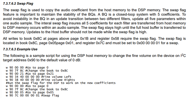

  • Hi Mohammad,
    The issue seems to be with your swap command, ensure that you go to page 0x05 and use the swap flag as shown in the datasheet.
    Alternatively, I would suggest using PPC3 to generate these commands and avoid any accidental miscalculation or error in register writes.
    Isaac
  • Hi Isaac. as mentioned in this link : (https://e2e.ti.com/support/audio-group/audio/f/audio-forum/1571027/tas3251-coefficient-swap-flag?tisearch=e2e-sitesearch&keymatch=tas3251%20swap# ) the swap command in the datasheet is incorrect and the correct one is as i wrote:
     //swap command
            { 0x00, 0x00 },
            { 0x7f, 0x8c },
            { 0x00, 0x23 },
            { 0x14, 0x00 },
            { 0x15, 0x00 },
            { 0x16, 0x00 },
            { 0x17, 0x01 },
    i wrote this swap command after setting the volume in the dsp registers. but it didnt work.
    in the first step i want to write a very simple code to test whether the DSP is working or not. (i dont want to set BQ, ... in this step).

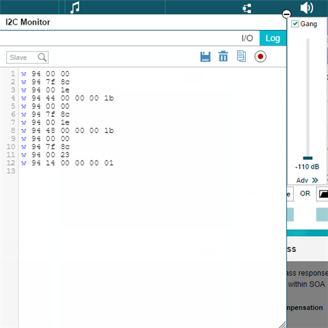

  • Hi Mohammad,
    It looks like you are trying to set the volume to minimum level of -110dB, to do this you must write the value '1b' to registers 0x47 and 0x4b. Right now you are writing '00' to these registers which does not correspond to a volume level. I've included a code snipped below for this from the PPC3 I2C Monitor:
    You can use the I2C monitor to see how changes made in PPC3 will be written in I2C and see which register values the changes correspond to.
    Isaac

  • Hi Mohammad,
    Can you try using PPC3 to generate these register values? It is the preferred method for device initialization. You can make any DSP changes necessary and then use the 'End System Integration' section to create a cfg file.
    Isaac
