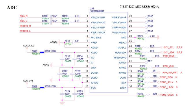

    Hi Garret,
    Thank you for your reply.
    We would also like to provide one additional observation:
    LRCK=48K
    BCLK=3.072M
    With the current register configuration, our understanding is that the PDM microphone data path is configured through GPIO1.
    In this case:
    • PDM microphone connected to GPIO1 → No audio can be recorded
    • PDM microphone connected to GPIO0 → Audio recording works normally
    The register dump and configuration screenshot are attached.
    Thank you for your support.
    Luke

  • Hi Garret,
    Yes, we switched the PDM input back to GPIO1.
    We selected PCM1863 because we need a high-performance TI audio ADC for this design. However, we still need to use the ADC for PDM microphone input, so we would like to confirm whether PCM1863 has any known issue or limitation in this use case.
    Our current test result is unexpected:
    • Register settings: 0x10 = 0x10, 0x11 = 0x01, 0x1A = 0x11
    • PDM CLK is connected to GPIO2 / pin 20
    • PDM DATA connected to GPIO1 / pin 21: no audio
    • PDM DATA connected to GPIO0 / pin 22: audio can be recorded
    Based on the datasheet, this configuration should select GPIO1 as the PDM data input. Could you please confirm whether PCM1863 supports PDM DATA input on GPIO1 / pin 21, and whether GPIO0 / pin 22 is a valid and production-safe option for PCM1863?
    Luke

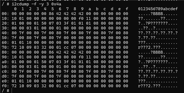

  • Hi Garret,
    Thank you for your response.
    I followed the register configuration steps you provided for the PCM1863, but I still cannot record audio from GPIO1. The waveform on the DOUT pin remains unchanged and does not reflect any data from the digital microphone. You can find my configuration steps in the attachment.
    A few days ago, I applied for 10 PCM1863 samples from the TI website, and I received them today. I tested again using these new samples, and the result is the same, which confirms that my PCM1863 devices are not counterfeit.
    I have made a new observation: I found a way to successfully record audio from GPIO1, but this method does not use the Mixer Coefficient settings. My register configuration is listed below:
    Write register: 0x00 Data: 0xFE
    Write registers: 0x06 / 0x07 / 0x08 / 0x09 Data: 0x40
    Write register: 0x10 Data: 0x10 (configure GPIO1 as digital microphone input, GPIO0 as GPIO)
    Write register: 0x11 Data: 0x21 (configure GPIO2 as digital microphone clock output)
    Write register: 0x19 Data: 0xF0
    The key point is the configuration of register 0x1A:
    If I write register 0x1A = 0x11 (set Digital Mic Data Input to GPIO1), I can record audio from GPIO0, but not from GPIO1.
    If I write register 0x1A = 0x01 (set Digital Mic Data Input to GPIO0), I can record audio from GPIO1, but not from GPIO0.
    This behavior is the opposite of what is described in the datasheet.
    I have the following hypotheses, and I would appreciate your help in verifying whether they are correct:
    The datasheet may have the GPIO0 and GPIO1 mapping in register 0x1A reversed, or there may have been a misalignment during channel mapping. This would explain why when GPIO1 is configured as input, audio can only be recorded from GPIO0, and vice versa when GPIO0 is configured as input.
    As I mentioned in my previous email, during earlier tests I observed that the digital microphone data does not appear on I2S_L and I2S_R. The datasheet repeatedly states that the digital microphone input passes through the Digital PGA, and in Figures 26 and 27, the digital microphone data and ADC audio data share the same path into the Digital PGA. However, on page 33 in the PCM signal description, it states: “The incoming data are then driven to the digital mixer running on DSP2”, which implies that the I2S signal is driven from the DIN pin into the mixer and does not pass through the Digital PGA. This suggests that the digital microphone path and the I2S path are not the same. The digital microphone data may actually use the CH1_L and CH1_R channels, while the I2S signal clearly uses the I2S_L and I2S_R channels.
    I would appreciate it if you could help confirm whether these assumptions are correct.
    Luke
