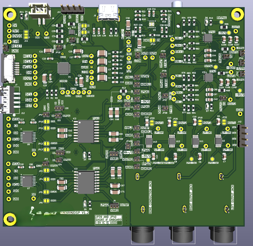

I am experiencing audio crosstalk on my audio driver PCB and would appreciate some help identifying the source.

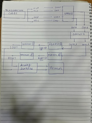

Signal chain:
MCU (I2S/I2C) → TLV320AIC3104 → OPA1622 (buffer) → OPA1612 (Sallen-Key filter) → PGA2311 volume controls → TPA6120A2 → TS12A12511 analog switches → receiver outputs.
The board has two audio paths: Tone and Masking.
Problem:
When both analog switches are enabled at the same time, I can hear the Tone signal on the Masking output. The issue is most noticeable when the masking volume is set to a very low level. The leaked tone is clearly audible.
PCB details:
  • Split ground plane used.
  • TLV320AIC3104 located on the left side.
  • PGA2311 located on the bottom-left side.
  • TPA6120A2 located on the top-right side.
  • Analog switches and mono jack connectors located on the bottom-right side.
  • Ground planes are connected through a 0-ohm resistor.
  • I have also tried adding multiple ground stitching vias between the ground sections, but the leakage is still present.

** 3D view of my PCB is attaached
**Note that the board layout is of 2 layers

  • Hi Falguni,
    There are a lot of stages between the codec and the receiver outputs. Have you probed to see where the leakage starts or how far back up the chain it is?
    Would you be able to provide a schematic as well so I can see how the codec is connected to the two output paths?

  • Thank you for your response.
    I am not able to clearly observe the leakage on my oscilloscope. Even when I reduce the vertical scale to 1 mV/div, I do not see a noticeable sine wave on the receiver output where the leakage is heard.
    The leakage is only audible under the following condition:
    • A tone is being played on the left channel.
    • The right channel output path is also enabled.
    • The masking volume on the right channel is set to a low level.
    In this situation, I can clearly hear the tone signal leaking into the right receiver output, but I am unable to capture a corresponding waveform on the oscilloscope.
    Could this indicate that the leakage level is extremely small but still audible through the receiver, or is there a better measurement technique you would recommend for identifying the source of the crosstalk?
    In the meantime, I have a question regarding PCB grounding practices for mixed-signal audio designs. My signal chain includes the TLV320AIC3104 codec, PGA2311 volume controls, TPA6120A2 amplifier, analog switches, and digital interfaces such as I2S, I2C, and SPI.
    For this design, I used split ground planes, with the analog and digital sections separated and connected through a 0 Ω resistor. I also tried adding ground stitching between the planes, but the leakage issue remains.

  • Hi Falguni,
    If you can't see it on a scope, is it possible to control which stage is active between the left and right sides? For example, you leave the left channel in normal operation, and then you mute the right channel at each device going backwards up the chain. You mention that the right channel is enabled but playing a very low volume so I wonder which device the crosstalk is coming from.
    If the crosstalk is not very loud it could be difficult to see the sinewave on a typical scope. If you have any kind of FFT function on the scope or someway to measure the frequency domain, that might give more insight into how the crosstalk is performing.
    If you could also send me your I2C configuration script I can check on my EVM to see if the leak is happening at the device, since you mentioned you've already taken a lot of steps at controlling the layout. I have seen in the past leakage issues happening based on the order in which the registers are written to. I'm not sure that's what's happening here but I could still check it if I have your I2C configuration. Order matters so I would need a script, not a register dump.
    Regarding the ground planes, I would go with split analog and digital planes by default. Audio is a very sensitive application so it is usually worth the effort to keep digital noise away from the analog signals. However you can achieve the same by carefully managing the return currents for the supplies and analog signals i.e. your third option. This is of course dependent on each device and their own requirements but that's my general rule of thumb.

    I also have a question regarding the grounding strategy.
    My board uses separate analog and digital ground regions connected through a 0 Ω resistor. After adding ground stitching vias between the ground regions, I noticed a significant improvement in the crosstalk issue. This makes me think that return-current paths and grounding implementation may be playing a role in the behavior I am seeing.
    For future revisions, if I continue using split analog and digital grounds, what would be the recommended implementation on a 4-layer PCB?

  • Hi Falguni,
    The datasheet has a layout guide but it's hard to see the ground split. I have made a drawing of it below.
    You should do something like the following
    Top Layer - Signal layer with split ground
    Middle Layer 1 - Ground Plane with split ground
    Middle Layer 2 - Power Plane
    Bottom Layer - Signal Layer with split ground
    I think keeping the grounds separate on each layer will prevent any accidental signal crossing. You should minimize any signals crossing the boundary and if they do, you should take care that their return path doesn't intersect another path from the other plane (digital to analog or vice versa).
    A small amount of net ties (2-3) should be enough to join them together. Try to do this away from the device.
