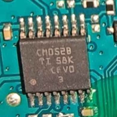

Share the datasheet for attached IC. Seems like the code display is CM0528.

This device appears to be the SN74LV8151 10-bit universal Schmitt-trigger buffer with 3-state outputs according to that trace code. Here is the link for the datasheet: SN74LV8151
