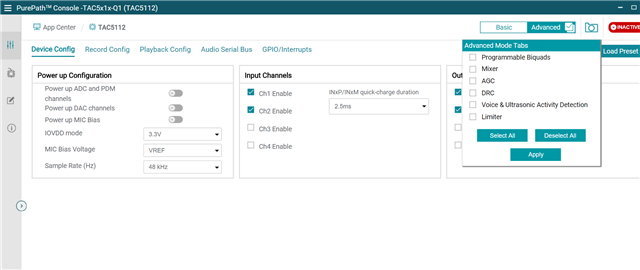

    I got the software installed. In the end maybe it seems PPC does not have any configuration settings for the DAC mixer or the BiQuads etc? Even the "register map" tab only shows register pages 0,1 and 3, but the device has several more. But thank you for approving the software download, it is still helpful verifying the other settings.
    I haven't had time to go over the other document Garret linked but i will update if i can't sort it out with that.
    S
  • Hi Scott,
    You can enable these in the "Advanced" settings section:
    Click the Advanced tab, check whichever settings you want to configure, and click Apply. They will appear next to GPIO/Interrupts.
    Garret
  • Hi Garret,
    Ok thank you for showing me that. I had tried clicking on "Advanced" but not the right side with the check mark, which does bring up the menu you showed.
    Thank you very much. I will try this out shortly.
    S
