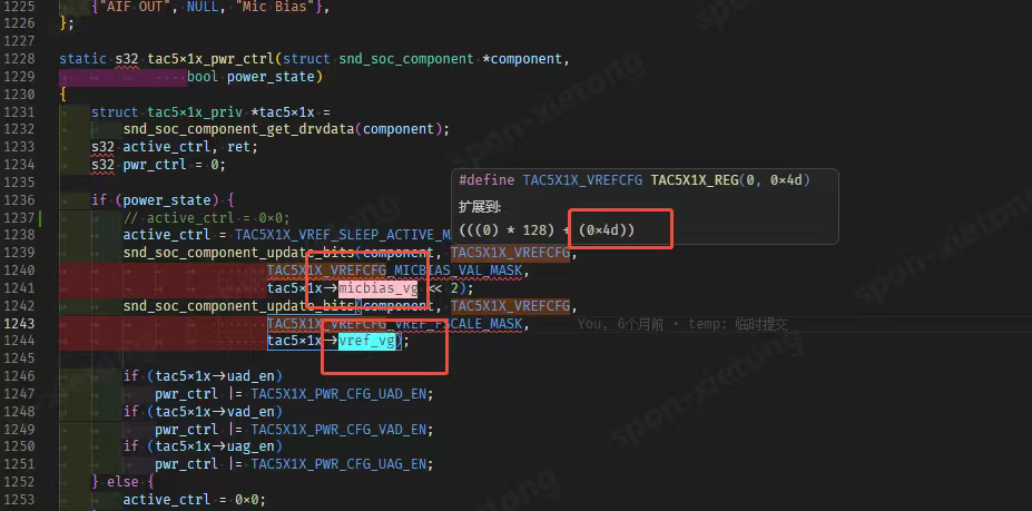

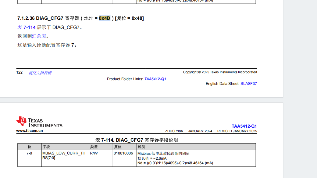

The datasheet describes setting the threshold for low current fault diagnosis of Micbias, but the driver has configured Micbias_vg and vref_vg from dts. Is there a problem with the driver or the documentation?
