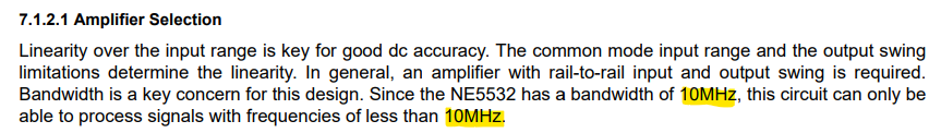

Is the 10 MHz figure listed in the datasheet below the same as the Unity Gain Bandwidth?
If so, shouldn't it be 12 MHz? Is this a mistake?

As you may be aware, there was a product change notification sent out on this device. The GBW or gain bandwidth product is 12MHz for the new device.

The electrical specifications state 12 MHz, but the text in the datasheet I sent you specifies 10 MHz; I assume this is a clerical error—is that correct?
Please update the datasheet.

Chris is on time bank, but the datasheet should be updated and available online within the next few months.
