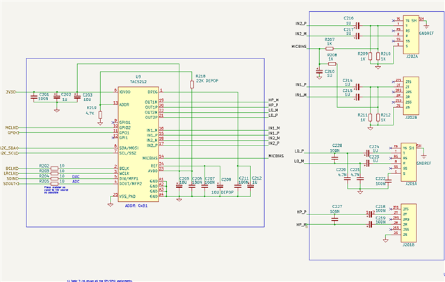

TAC5212: Audio output problem in single-ended mode
Other Parts Discussed in Thread: TAC5212

  •   Hi, Could we get the regdump and schematic on how it is being used. I will check internally and come back. thanks
  • The register settings are in the ALSA amixer dump above. the I2C address is used by the driver, so i2c dump is forced dump. The schematic as follows.
    All the in series in and outputs are 1 uF.  C218 and C219 are also 1uF.  C222 is 0R to GND. Other caps and resistors are not assembled (yet)
    The TAC5212 is in slave mode (as  the  TAC5x1x branch 5.15 driver only supports that mode) so MCLK and GPO1 are not used .

    AFAIK. 4 single ended independent output signal is only possible in PDM mode ?
    The requirement is that the user can chose between
    1. OUT1 as Left and OUT2 as Right differential line out level
    2. OUT1 as left and  OUT2 as right as single ended  (OUTP or OUTM) line level
    3. OUT1 and OUT2 single ended stereo line out line level  (as I understand OUT1 & 2 will carry the audio)
    4. OUT1 and OUT2 stereo single ended headphone out  (as I understand OUT1 & 2 will carry the same audio) [This topic]
    5. OUT2 as line-out stereo and OUT1 headphone stereo ( (as I understand OUT1 & 2 will carry the same audio)

    I found the reason, The speaker scripts sets the volume at 100, then there is noise of around 140mVp-p. so changing back to line out, there still was no signal becaus that script did not set the volume.
    For the headphone, at 200 there is a clear analog sine wave output of 1.8Vp-p .At 255 the sine  wave playback becomes a square wave at 1.72Vp-p.
    Is that right ?. The outputs only have a series capacitor. no resistors or anything else.
