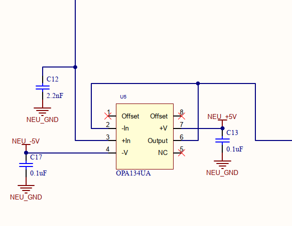

We are using IC OPA134UA in deisgn. We are giving 5V to V+ and V- pins of the IC and the Input voltage is coming to +In 3rd Pin of IC is 5.8V.
I am attaching the connection diagram of the IC. I have below questions-
  2. Can we give 5.8V to 3rd Pin?
      2. What would be  the output voltage at Pin 6? We are getting 4.3V but do not understand how it is coming?
Please clarify.

    The input signal of an op amp cannot exceed the power supplies of the op amp. In addition, a 5.8V input signal would violate the input common mode range of the device. The VCM range of the OPA134 is (V-) + 2.5V <VCM < (V+) - 3.5V. For a ±5V supply, the VCM range would be -2.5V < VCM < 1.5V. Therefore, the maximum positive input signal on IN+ would be 1.5V.
    Likely, you are measuring 4.3V at the output because you are operating in a nonlinear state. A simple solution here would be to increase the voltage supply of the OPA134UA to ±15V. Since the circuit is in a buffer configuration, the output should match the input signal of 5.8V.

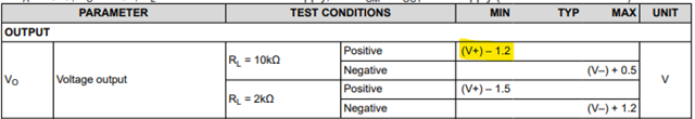

    The reason why you are seeing the 5.8V signal on the output is due to the input common mode range being violated. It seems like the output is swinging to the positive rail, which is 1.2V from V+. In this case, the output would swing to 5.8V on a 7V supply.
    We generally do not recommend designing circuits around the nonlinear behavior of the op amp. If you would like to keep the input signal at 5.8V, I recommend further increasing the supplies, perhaps to ±10V, such that the input common mode range and output swing of the amplifier is not being violated.

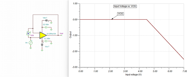

    I think there are two different interactions at play here. Although the input common mode may be violated, the op amp won't be damaged, but you will increase the error of the device. For example, the VOS will drastically increase as you exceed the common mode range (see simulation example below where the difference between the input and output voltages increase).
    Even though the maximum input common mode range is 3.5V (for a 7V supply), the output seems to behaving in a linear manner, reading 5.8V. However, the output also a limitation of 1.2V from the rail typically. It's possible the amplifier was reaching the upper output swing limitation of 5.8V, which in turn looks like the amplifier behaving in a linear manner.
    How are you measuring the IN+ signal? Are you basing this measurement off the input signal itself, or do you have a probe on IN+? Can you send me a screenshot of both the IN+ and OUT node in your current setup?

  • Hi Shiv,
    If you increase the supply voltage to +/-9V, then the output should still saturate at 5.5V (see simulation below).
    However, if you increase the supply voltage to +/-10, then the input voltage will match the output voltage (see below).
    If 5.5V is an acceptable output voltage for your application, then you can keep the changes you mentioned above. Otherwise, I recommend increasing the supplies to +/-10V.
