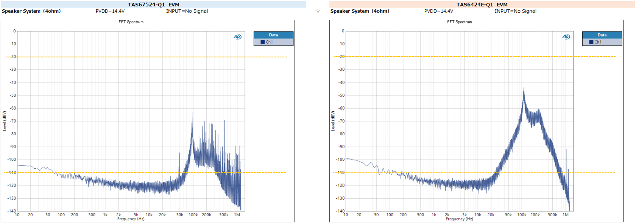

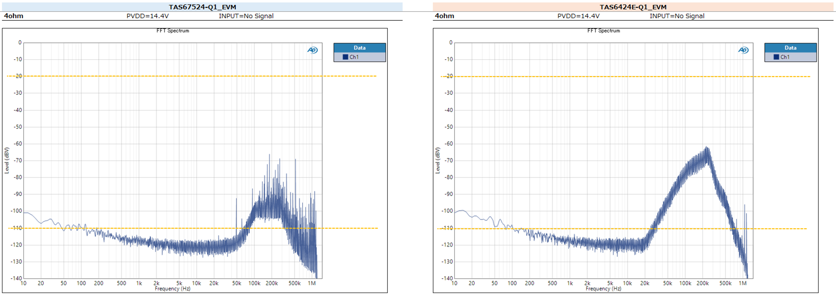

First, the characteristics under a 4-ohm load and an open-circuit load are as follows:
Next, when a typical speaker system is connected to the EVM, it exhibits the following characteristics.
Although a tendency toward LC resonance can be observed, there are no significant issues.

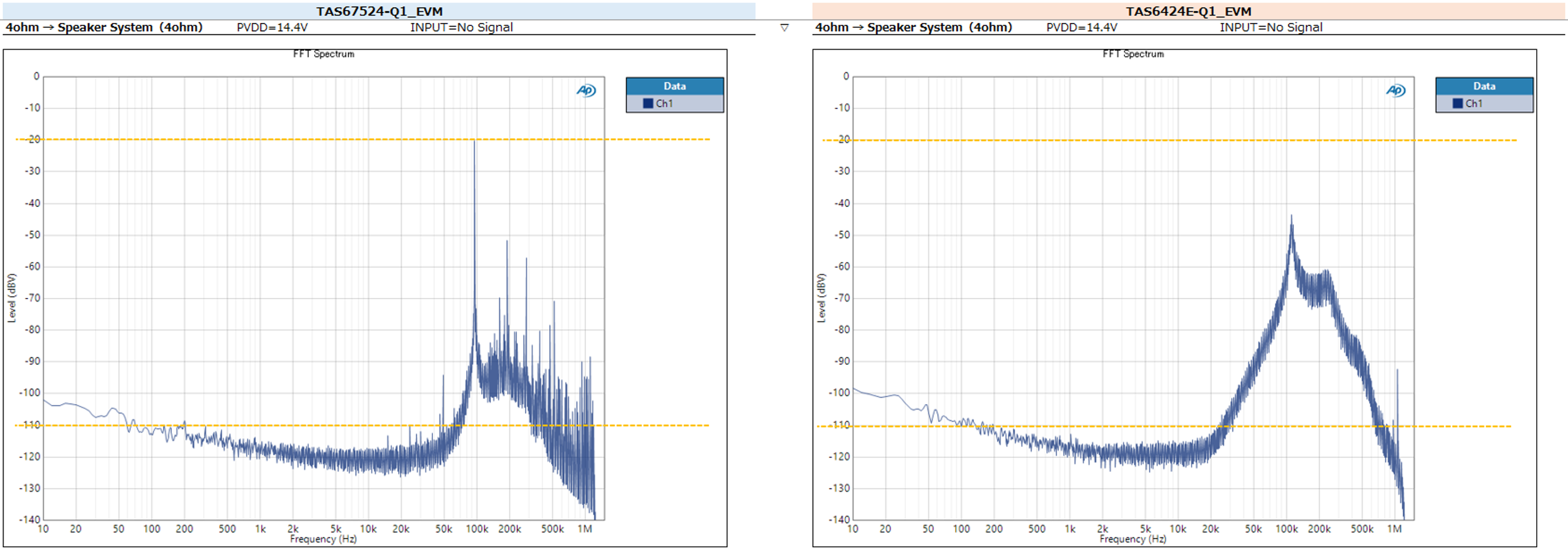

Finally, here is the characteristic in question.
The unit is powered on with a 4-ohm load connected.
Then, while in Play Mode, the load is switched from the 4-ohm load to the speaker system.
This might seem a bit tricky, but it simulates a change from the end user’s perspective.
The TAS6424E-Q1 shows no particular change.
However, the TAS67524-Q1 does show a change. It behaves almost as if the load were OPEN.
Why does this change occur?
It appears to be a change specific to 1L Modulation—what do you think?
Please let me know the cause of this.
In this case, I presented the characteristics using a Speaker System load for clarity, but the same trend is observed with a dummy resistor as well.

  • Hi Kenji
    It feels like, when TAS67524 make this changes, there's likely to be more oscillation, similar with open load. Kindly use oscilloscope to confirm it.
    It's hard to tell the exactly reason. Just from the testing method, seems the oscillation would appear during the load transition moment. And after speaker connected, TAS6424E dumped better.
