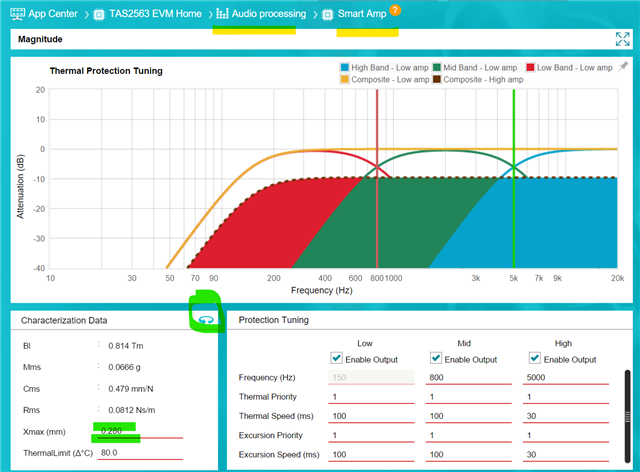

  • Hi Hitoki Ishikawa,
    first, please confirm the excursion protection is running correct by below method:
    goto below page: audio processing -> smart app, the left bottom corner, change the xmax to a very small value like 0.0001, and change the thermal value to 1000.
    if you don't see this page, click the "turn around" button in green.
    and meantime, please disable all other processing modules.
    after these setting, save the setting to SS and generate a new bin file. check the output.
    it should output a much small signal than previous normal value.
    after confirm the excursion protection running correctly, you can change back the thermal protection, or other modules. to check which module is the bottle neck.  sometimes, the excursion is not the bottle neck, so you will not see obvious difference even there is no excursion protection, because other module limit the output to a limited level which will not trigger excursion protection.
    Br,
    Wenbin
    please share the results with my method ( change the xmax to 0.001).
    usually, the output power is not related to the excursion protectly strictly. the excursion protection only limit the max output power, but the tested power usually is the average. even the protection is running correct, the tested average doesn't change obviously.
    Br,
    Wenbin
