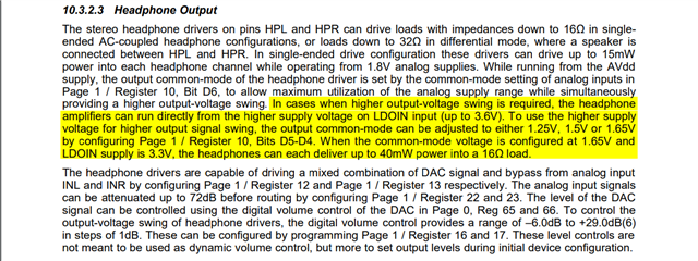

I am useing the PCM3070 s HP outputs single ended, i want to use LDOIN as HP power input in order to get a larger output voltage swing. There is no mention of this configuration but also no mention that it is not valid.

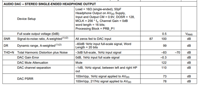

As for electrical caracteristics I assume Full scale output voltage (0dB) for singl eneded is 1/2 of the differential value. so about 0.889Vrms output?
Is this corect? or are there other HW limintations that reduce this value ?

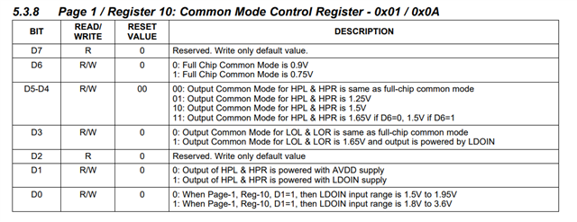

Should i set CM to 0.75V or 0.9V ? Page 1 / Register 10: Common Mode Control Register - 0x01 / 0x0A
I think i should set CM=0.9 and Output Common Mode for HPL & HPR is 1.65V .

  • Hi Robert,
    The datasheet does mention this exact configuration and it is valid to use.
    There are also specs provided for the single-ended headphone mode.
    You are correct though that half of the differential value is the supported single-ended value. The full swing depends heavily on the output common mode chosen, which is why you see different FS values in the spec table.
    This is fine. This will put your headphone common mode at half of the max LDOIN supply value. The input common mode setting of 0.9 doesn't really matter here since you will override it with 1.65V anyway.
