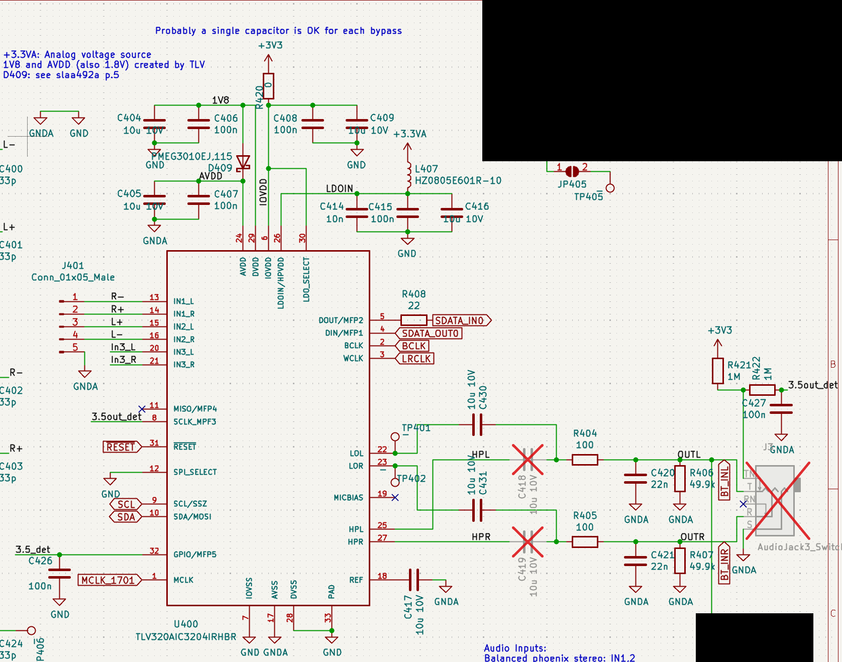

I'm having a hell of a time with pops on startup.  This happens if I use the line output or headphone output.  Relevant schematic:
Any ideas what's happening?

    Do you not see the diode I have in my circuit?   Is it not correct?
    We can't ship a product to customers that pops this badly during powerup, this is well beyond the usual clicks or thumps.  This is a >1V, 100us pop, and that's with a 1k resistor installed to ground on the headphone out.
    Diode looks fine.
    Otherwise the only things to help mitigate it would be see if your power sequence is following the plots below. I agree that sounds like a violent pop, but this device is pretty limited regarding what we can do around the rails hitting the device and causing the pop.
    The other thing I would recommend is to adjust the passives you have on your output, either remove one by one or swap values. The cutoff of the RC is much higher than audible (~70kHz) and slowing down the transient might help mask the pop.

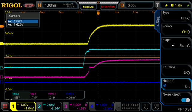

    I did measure the power sequencing.  IOVDD appears at least 600ms before anything else, and RESET goes high about 50ms after DVDD/AVDD/etc.  Here's a plot:
    Channels are: yellow=DVDD, cyan=LDOIN, magenta=AVDD.
    It looks like everything is satisfied - do you see any issue?

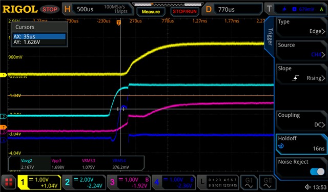

  • How here's HPL on channel 4 (dark blue).  It's a huge spike, basically full scale.  This must be something that can be mitigated.
  • Going back to line output (moved the caps back), I get exactly the same poweron spike as in the headphone case.
    But I also get a really nasty click when the 1.65V common mode and LDOIN supply is turned on (P1_R10 0x33 --> 0x3B)  A smaller thump happens at P1_R9=0x0c (line driver power on).
    How is this mitigated?  I can't accept that this is how this codec is intended to behave.
  • Hi Joe,
    Thank you for the plots. I think your power sequence looks fine. Since you are only providing LDOIN and IOVDD there's not much to do here. What you're seeing is how DVDD and AVDD are waking up, and when the diode kicks in to short the supplies together.
    What I recommend is to completely float the outputs first and see what the pop looks like. Whichever outputs don't have the caps on them, you can measure on the output pads. This just removes any variables in the output filter or the layout.
    The pop is also suspiciously close to the shape of LDOIN. If you have any method to slow down LDOIN (bigger coupling caps, small resistor, etc) I would be curious to see how that changes the pop profile.
    Another thing I notice is that the AVDD is slower as the app note says, but it starts ramping first (could be dependent on coupling and/or the drive of the supply itself). The diode doesn't get a chance to keep the supplies together. See if flipping the diode direction makes a difference.
    As a last ditch effort I would try to use a different power sequence. There a couple of other notes in the power sequences that comment on the pop of the outputs. Driving DVDD with 1.8V instead of relying on the LDO lets you keep LDOIN low until AVDD is present, which is mentioned to be a source of pop. In the single supply case, the diode should help with this, but splitting up the supply gives us more control at least for debugging. I know it's not in your schematic, but if nothing else is helping, I would try this to just to see.
