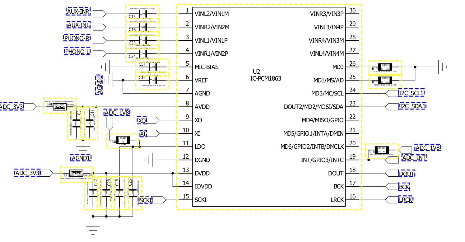

PCM1863: PCM1863 schematic view
Part Number: PCM1863
Hi ti team,
The new project is using the PCM1863. Please help check if there are any issues with the attached schematic. Thanks!
    I recommend AC coupling the unused analog pins to GND (pins 27-30).
    The inputs on VIN1 and VIN2 have L/R swapped from the input to the pin (L connected to R pin and R connected to L pin).
    SCL and SDA should be pulled up to IOVDD.
    I cannot see the capacitor values from the image, so make sure they match the datasheet recommendations for optimal performance.
